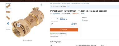

It's not leaking…. yet. The repair sleeve was already there. This is in the areaway (the outside entrance to the basement). My main cutoff is inside the house.
I'm in an old brooklyn rowhouse and there is no street cutoff on the sidewalk or the street. The cutoff is a "tap" buried 4' under the street level.
I found a guy who has a freeze cuff machine. Plan is to freeze the line. Cut out the bad section. And replace with Type k malleable copper 1". Connections will be made with 2 Pack joint unions.
PAck joint union also know as dress couplings.
Anyone have experience fixing a main with a freeze machine?

  • Damage is on the street side of my house main cut off. Just a few feet outside my house
  • Accessible shut off - Ordered one from supplyhouse. I'm might install it inside the house but before the meter. Initially I thought about putting it in an access box underneath the concrete of the basement landing. I think the freeze risk is too high. The access box will allow the cold ambient air to freeze the pipe i think.
  • Good advice on not trying to use a CO2. I didn't ask the guy what type of machine he has. Just checked my local tool rental place. They have the Ridgid SF2500. Can handle up to 2 1/2" pipe.
  • After pipe is repaired and insulated, I'm backfilling the trench with sand. Will have proper support.
  • I've heard the Pinch machine is the industry standard for mains. No one I've reached out to has one.
