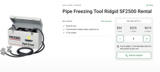

I have the Ridgid SF2500 superfreeze, as long as there’s no flow it works great. Takes a little practice to form the ice plugs but once formed they hold well. Just don’t shut it off till you’re done, i usually drill an 1/8” hole to verify no flow. The key is cleaning the pipe and securing the clamps. Keep spraying the connections with a water bottle to form the ice plug. I practiced on a straight piece of 1” copper connected to the hose before i did a line in service.

I've done hundreds of repairs with this machine, works great but you have to be patient. If you rent it I suggest doing some practice on a section of pipe attached to a hose with a valve on the end. When you think it's good open the valve to check, a clean tight connection is key & keep spraying water on it till it's about the size of a baseball.

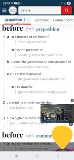

Well ok, I guess.
Before the meter is the line side and is owned by the utility.
After the meter is the load side and owned by the customer.Screenshot_20260511_221331_Chrome.jpg

I understand what you’re saying, and agree it’s the commonly accepted vernacular…. Just trying to make sense of the way he’s describing it.

Froze the line with the Ridgid, replaced 24" of damaged pipe. Practice run on a section of pipe connected to garden hose was a great idea.
Thanks for all the helpful insight.
