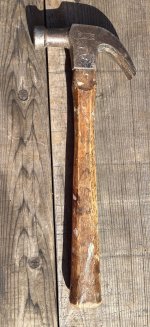

My second research stop was IA/ITCL.
The 1867 Stanley catalog shows a tack hammer/puller matching the original Conklin patent drawing. The 1870 Stanley catalog includes the same Conklin patent tack hammer/puller and an improved model (I only excerpted the new model below). The first Stanley catalog that includes a tack hammer/puller that is a spittin' image of the example I just found, called a No. 4, is 1872, hence my dating it to ca. 1872 in post #1, despite the slightly earlier patent and reissued patent dates stamped in its little boss.
30,660
Wear or shrinkage or both?
I am not familiar enough with black walnut (ironically, since I have a living tree in my back yard dropping a bushel of nuts this time of year! :)) scales to know, Outlaw. As you know, I have some very old H.D. Smith "Perfect Handle" tools, but none quite this old, and I don't know what wood they used, but none of those are as worn (or, as you say, shrunken looking) as this. It was extremely dry, which I remedied with Murphy's and BLO.
29,135
RE: Conklin tack hammer
see post #193. second image. top right.
same/same?
makes appearances on two or three other pages immediately following.
tells me it went into mass production or those wholesale hardware outfits would not have had it in their catalog, which makes the leap from Conklin to Stanley not too great a stretch.
30,660
^ Yes, that's it.
I didn't think there was any stretch though. The tack hammers shown in the 1867 and 1870 Stanley catalogs look exactly like the hammers shown in Conklin's patent and reissued patent. My hammer doesn't, but the dates that are stamped on it are Conklin's patents, and it appears in the Stanley 1872 catalog. While DATAMP doesn't have a photo of one, it clearly continues the trend of Stanley using his patent, as they indicate. Apparently, they settled on putting wooden inserts into the hollow area, and changed the head, but the hammer matches the main features of the patent claims. It's good to see it in other catalogs, especially later ones, but that 1872 Stanley cat pretty much nailed it, and it continues to appear in Stanley through 1898. I'm not sure why it's not marked Stanley, but that's a minor machts nichts for me with the patent dates and the catalog appearances.

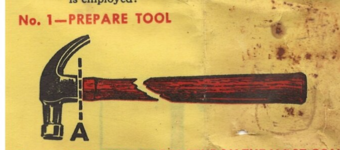

Posting this to preserve it. found in my dad's stuff. F.R. Plumb copyright 1953 - Plumb rehandling kit instructions.
scanned it before the mice finished it off. It mentions the Plumb Permabond adhesive.
More people need to read that!
I cant believe some of the janky-*** hammer repairs I've seen....

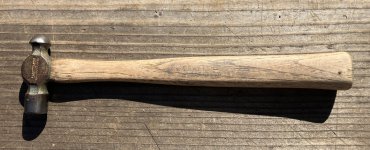

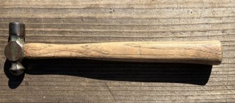

I found this small Craftsman ball pein hammer at an estate sale on Friday. I removed most of the rust and cleaned up the handle. IMG_6310.jpeg
The ink markings on the handle are barely visible. IMG_6311.jpegIMG_6312.jpeg
Mr don glad to see you out and about and posting. Happy hammering.
