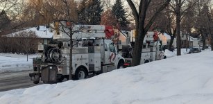

Right after new years I finally got power to the building! Not without a bit of hassle of course. The power company sent out two boom trucks and they couldn't reach up and over the roof to access the drop. But rather than leaving, the whole crew decided to nap out front.
So they sent out two bigger trucks. They too were shortly napping across the street. A couple hours after that we got two of the BIGGEST trucks and they were able to reach. The crew knocked it out and were off on their merry way.
I wired in a couple more 20 amp circuits and added enough outlets to eliminate all the cords I had running from the house. That felt like a big step. Next I got 2 of the 4 LED panels that will light the back half of the garage in. Honestly, I was super underwhelmed. I had a single one of the panels in my old garage and, while obviously a smaller space, it was nearly blinding. On a hunch I swapped over from the motion sensor / dimmer switch I had installed to a standard one. Ta Da! All the light. I guess the panels are wired for an internal proprietary dimmer so it was only putting out the minimum amount of light. I also got one of my external garage door lights up. It looks a little cocked eyed for now, but I needed to see if I was going to stick with this style.
