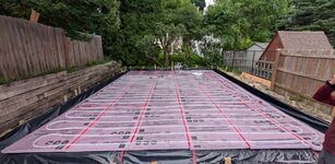

Took another big step this weekend by getting the slab insulation and PEX ran for radiant heat. It was honestly all pretty smooth and I had a hand later in the day to help wrangle the PEX, which made it go so much smoother.
Uponor has such a helpful piece of software on their website to help design your loops. You essentially fill in some key details about your building like wall construction, concrete details, window/door openings and it will spit out your loop layouts, all the components needed, as well as some nerdy data like expected heat loss, etc. VERY helpful for wrapping my head around what was completely unknown to me.
Here's the layout that was suggested.
I started by laying 6 mil poly underlay then 2" foam insulation over that. I taped all the poly joints and the foam together.
Next we just tried to match the layout as close as possible. The foam insulation has a built-in grid that saved us tons of measuring.
Almost looks like we knew what we were doing!
Next up is rebar, first inspection, then concrete 🤞
