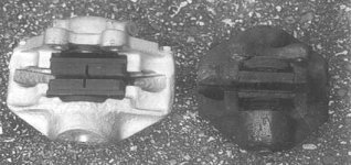

Had a look at the drivers side front brake on the bug today. With the wheel off the ground it didn't spin freely. The caliper's outer piston was quite stiff to push back to remove the pads. Inner was free though.
I did the passengers side one back in November 2023 with new seals but didn't touch the drivers side as it was fine at the time.

Got the beetle's caliper reassembled and bled. Just been for a bit of a test drive and its no longer so hot you can't even touch the wheel. 👍

My 1988 caravelle has the sliding calipers and the slider pins stick every year or so. They're easier to remove and reinstall the piston though.
These calipers were off an early 1980s Talbot Horizon (same as a Dodge Omni in the US) and are huge compared to standard beetle ones. About the same size as a vw bus uses. 48mm pistons vs the stock 40mm in a bug's.
