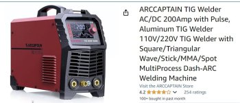

What machine? If using an inverter, your tungsten is the problem.
Also... turn pulse off, especially if its your first time with aluminum. Not needed.

ArcCaptain is budget basement Amazon machine, so you have to assume some things may not be as they should be. Once sorted out, they can work well enough, but it's common to have to be the final stage of quality control. Just as it is with Everlast or Primeweld or other priminent lower-budget machines.

Run 2% lanthanated tungsten and throw the pure tungsten in the scrap. It’s not meant for inverters. I recommend 3/32” diameter for general work, 1/8” for thicker stuff like 1/4” aluminum.
I’d be running a #5 or #6 cup, 25-30 CFH on my gas. Pure argon.
You want as much amperage as that little machine will give you, likely 200. It may not be enough without a little preheat.
Adjust your balance to give you just enough cleaning action to make a clean puddle and go from there. I’d start with 70% EN and see if that works.
