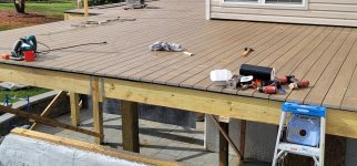

Jar: I’m sorry I don’t check your threads more often cause I always love your work and skills. Best of luck on getting the master done so you can move out of the basement. I recall several times usually when my bride was pregnant when I’d be updating the kitchen or bathroom or something and I’m happy those days are in my past so good luck.
Do you still love your timber tech (or was it trex) decking? Any tips on cutting it? Which blade and maybe in the morning before sun heats it up to get actual measurements. I’m not going to picture frame my 32x16 deck so I’ll have exposed ends. I can try to cut ends next to house so factory ends are exposed or would a 60 tooth blade and maybe painters tape on top where I’m cutting do ok?

The deck was timbertech, no complaints it's been holding up great. As for blades, I was just using whatever generic blades I had. I didn't want to ruin a good trim blade. I ended up running everything long and cutting thr ends with my track saw (28t general purpose Tenryu blade).
I ended up working on the deck in all sorts of temperatures so I'm no help on measurement differences.
