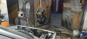

I started repairing my Oka car. I've been dealing with an oil leak from the engine for a long time. At first, it was just a few drops at night, but now it's like a constant drip like rain. This happened after I drove my Oka car for a couple of dozen kilometers in search of gasoline. When I arrived at the garage, I noticed these traces on the floor and a pool of oil under the engine.
I realized that I couldn't delay any longer and needed to find and fix the issue. I had to remove the engine. It wasn't an easy task, but I managed to complete it.

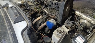

It's the second day, or rather the evening, of searching for the source of the oil leak in the engine. I believe I have found and resolved the issue. When I removed the flywheel, I noticed that there was an отсутствующий bolt on the rear cover of the engine. This bolt is located near the oil channel that drains oil from the engine head to the crankcase. I marked the place where there was no bolt with a red arrow.

Vladimir
Great job finding location of the oil leak.
Now you will forgive me as I have bad memory! Did you not have similar oil leak issue with this engine or was it another Oka engine, sometimes back? Or may be I am just hallucinating 😀?
V
Vieux
Jan 31, 2014
2,544
Russia
Vladimir
Yes, it was this engine. I then replaced all the gaskets and oil seals. Because the oil was flowing out of all the cracks. It helped for a short time, the oil stopped flowing from under the gaskets and oil seals and the oil found another way. :) In order to solve this problem, the engine had to be removed from the car.

Day 3. The engine is in place. It was easier than I expected. Now I just need to install the accessories, fill in the oil, and add antifreeze. Then I can perform a test run.
