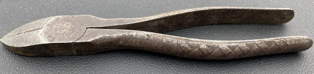

Well, another find in my own shop. I can only surmise I must have picked this up at auction at some point prior to beginning my journey to restock old socket boxes. This is an American KAL Inc 1/2" drive deep 12 point set. The box is OD green and oozes military issue but no labels nor NSNs. Sockets are marked with size and KAL-USA. There's one oddball 1-1/16 that's clearly not original to the set. It appears I need the 3/4, 9/16 and maybe a 1/2. Sockets are 3-1/8" in length. Alas, no catalogs on ITCL...perhaps circa mid 1980s?1000026648.jpg1000026649.jpg

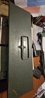

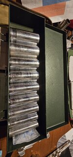

Are these sockets ProAmerica?
The numbering for these metrics is 57 followed by the size in mm. I found a few examples of PA using this same scheme, but the only makrking on these are the number, size and USA.
Fedwrench
Dec 9, 2007
14,974
Valley of the sun
Could be. Given that those sockets are plain jane 12 points, they could be from a government contract as well sourced from any number of folks back in the day like Easco or Granco. :dunno:
