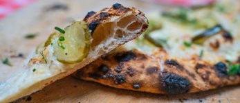

Here is the only photo that I took of the whole pizza thing for the week. It is a special photo though because this is Marty, a Garage Journal regular and follower of this thread who took time off from his duties as Mayor of St. Paul, OR which is about the size of Westcliffe, CO where I grew up - about 400 people. It's famous for its massive July 4th rodeo. Anyway, this was the only 30 seconds that I stopped making pizza for three hours.
Nada hired her boyfriend Luca and Lucas hired his friend Noah to assist and we did a test run last Wednesday to run through the menu, teach Luca some of our process and let him have a chance to run the oven. On Friday we packed up and drove the equipment to the coffee shop and spent some time trying to figure out how to arrange the tables and then how to stage dough so it would come to temperature at the right time. We decided to just leave half of the dough at home in the fridge because we'd decided that for our first night with limited publicity outside of some instagram posts we'd probably sell around 40-50 pizzas which would still be our biggest night ever.
For more photos check out the Luna Pizza Instagram.
Long story slightly shorter: we were slammed from 15 minutes before we opened until we closed at 8pm and we sold over 90 pizzas. My friends, Judiaan's friends, moto friends and some of the coaches from the kids mountain bike team all showed up and helped to make the night super busy. I was a little sad that I could see a table of my different friends, Katie, her family, moto friends, photo friends all sitting together and I could not spare more time than to say hello and apologize for the wait.

These photos are from the test bake we did. We're using a 58% hydration which is lower than what we feel is optimal which is 62% for "our" style of pizza. We do this in order to promote the browning and crispness that we like and that you can see in the photos above. Our main problem is that these ovens don't have the mass or gradual temperature gradations that we want or need. We get perfect results in our home oven because we run it on convection broil with the pizza's on the bottom on a steel. Steel gives its heat faster than stone, the 8-10" from the broiler slows the cook to 5 minutes at 550F and the convection means you don't need to turn it.
To get close to that with the Roccbox means we go with a lower hydration than we'd like losing some delicacy. We need to spin the pizza's every 15-20 seconds and we need to run the ovens on low so as to get that browning which makes the crust "eggshell" crisp while soft and chewy in the middle with lots of airy bubbles.
In full tilt production, going as fast as we can with three ovens we lose too much heat on low and the second and third pizzas were launching into ovens that were 400F at one point - and we had to toss those as they were under baked. That put us further into the weeds. Lucas' solution was to turn up the heat midway and constantly check the temp with the Fluke and rotate them as much as he could while letting each oven have approximately 3-4 minutes for recovery.
I'm beyond impressed with Lucas' ability to trouble shoot that, manage that, adjust and stay focused in the middle of service. When I'd check in with him he never once cracked a smile. He just buckled down and worked his *** off.
So we don't have a solution. I might try to have that steel cut for the Ooni we bought and see if that could possibly change things but what we need is a real honest to god pizza oven. I have sketched out a bunch of ideas but much like the hot rodder's mantra, "There's no replacement for displacement" and that turns out to be true for pizza ovens.
