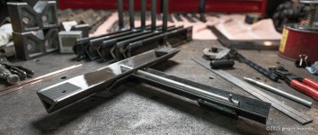

So months ago I volunteered to build new target carriers for our gun club. Years ago when Ben was coaxed into running for president (won in a landslide) he said he'd only do it if I ran for Pistol Director which I did (won in a landslide... because no one else wanted to do it). Our team has done very well and I've enjoyed my role and the coaching but more the camaraderie of the team.
Anyway, as the team has grown (now the most active part of the club) we've expanded the number of shooters and the number of points used. And the club is old and equipment is failing. Ben and I built a new target turning system but the main way that people move targets down range is a trolly with a hanger.
It's just angle iron, a rod and some binder clips. Simple enough but welded with a stick and close to zero skills. The club was and is self built so you get what you get. Ben measured and drew a new carrier and I made a few changes that I'd hoped would make the carriers bulletproof. So to speak.
I started by cutting a rod and machining the top down and then brining it to the club to test the fit. Frustratingly the trollies use a non standard ID for the rod so all the rod had to be turned down slightly removing .015".
I went with slightly smaller angle in the same 3/16" thickness, mostly for strength. Yes, it was a pain to do all this in imperial measurements.
After fixing the cold saw coolant pump one of the handles on the vise broke. The vise was a mess when I bought the saw and I tried to fix it to the best of my ability at the time but you can see that the welds holding the back are... horrifying. Every time I use the saw I see these over cooked welds and the massive slop and I think... some day I'm going to fix that. I'm trying to collect small projects like that for me to practice shooting video on and try to streamline the video process so it is as easy for me as stills.
Clean up the ends and put a heavy chamfer on to make putting them in easy.
Something you may notice is I'm trying to be more deliberate with my light. Again, it's for video but also because, as I see my career slip away to AI I want to hold on to it a bit longer, lean into it and enjoy it while it lasts. I have no idea what is going on in the world right now but none of it seems particularly hopeful.

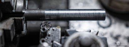

When I got my first South Bend lathe I remember trying to turn some mild steel and getting a ******, striped surface. The guys in the shop gave me a few tips on feeds and speeds but nothing ever helped. Eventually I learned that "it is what it is" and for the 20 rods that I had to turn from .6250" to .6100" I found no solution. I searched and searched and found a lot of things but none worked.
I have a bunch of 1/4-20 taps but I wanted to use my tapping head and go faster since I'd be tapping about 44 3/8" blocks. I tried to use a drill/tap but snapped it in the hole so I went back to drilling all the holes and then using the tapping head with a spiral fluted tap.
This combo worked so well. The tapping head is a Kato that I got off ebay ages ago. It gets used about once a year and each time I feel that it was completely worth the $50 or $75 that I paid for it. A tapping head, if you've not seen one, holds a tap in a chuck that is tightened with slim wrenches (I made mine out of some aluminum - the triangles you see on the table) and as you feed the head down the tap will engage and rotate forward at half the quill speed.
You'll notice that the middle in the shot above isn't spinning. That holds a bar which needs to hit the drill column or, in my case, the new post that I had to make on the back of the mill vise. The head always spins clockwise but when you lift the quill to remove the head the tap reverses out at twice the speed. It also has an adjustable clutch to keep from breaking taps (which wasn't adjusted correctly when I broke the drill/tap) so the process is super quick and very simple.
Next I put all the parts into a bin and covered them with 2 gallons of white vinegar to remove mill scale. There wasn't any on the rod or bar stock but the angle was pretty bad.
About 36 hours later the parts were covered in what looked like fur but was disolved scale.
I then ground the surfaces to be welded to get to clean metal. All the parts are basically prepped and ready to weld now but I'll divide this into at least two posts.

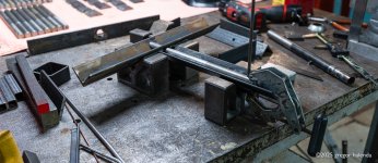

Getting close on the target hangers.
I rinsed them with baking soda to neutralize the vinegar. Supposedly you can use Coke to strip mill scale but it's a weaker acid and will take longer. White vinegar is less caustic than muriatic acid which is another way to go. Vinegar is the happy medium I think. Anyway, baking soda and the hottest water I could get so that the steel was warm enough to dry quickly and resist or not flash rust much.
Some of the earlier angle parts were not as precise because I was using an older end mill...
...and it was doing a fine job but at some point I didn't tighten the vise enough and it grabbed and walked. I forgot these shots because they happened a while back. The endmill chipped and one part got some digs but it's angle iron and will be shot at. Not a big deal.
But this left me without a 5/8" end mill (save for a two flute which I'd never subject to this sort of off angle cut in steel). I decided to take a bunch of endmills and center drills into Oregon Carbide Saw to have them sharpened. And since I was going there anyway I pulled the blades from the cold saw, the Festool TS55 circ saw and the KS120 miter saw. The cold saw has multiple blades for different thickness and material and my main medium blade does most of the work so I asked if they could make a new one in a slightly finer count. They offered to do that while I waited as they laser cut the blanks and then they go into a machine for the teeth. I considered staying to shoot the process but didn't bring a real camera. So another time I will because I think the process is really fascinating.
There were no 5/8 endmills in Portland but I found a long anular cutter. It's like an end mill without the center or like a hole saw on steroids. Mostly designed to be used to cut holes with a mag drill I decided to give it a try and was surprised (though I shouldn't have been) that it made the cut much easier, faster and cleaner. The center is the most difficult part of drilling any hole as the speed is near zero and the pressure is greatest. Anular cutters don't have that problem.
So there were a number of these that were bored with the end mill and they were not very tight but the anular cutter parts were super tight and clean. I will get more of these.
I rarely do production welding so I don't build jigs too often but I do like it. With the few that had a looser fit I needed to hold the parts inline and level and to set the through height of the rod so I built this jig. Here I'm setting a pin to locate the rod at the correct right angle and the correct height.
I'm surprised at my welds. It's obviously easier to weld the heavier material (though my attempts on the cold saw vise would indicate otherwise) and generally my technique is to "lay rod" where I'll chose a filler and lay it in the bevel and then pulse over it while putting gentle pressure to feed a bit of extra rod.
I gave the parts another run with the scotchbrite belt to get rid of the flash rust and then tacked them in. On the looser fit ones I would put a few tacks on the inside of the rod and then tap it square.
Once I was happy with the squareness I'd double tack on both sides then weld the inside. For some reason, after 15+ years of welding but never feeling very good at it or being able to consistently dip my rod and manage my heat it seemed like suddenly I leveled up through lack of practice. Again, heavy steel can take all the amps but still I'm very happy for a change.
My first one wasn't great. My second was pretty good and my third was on point. I started with full circumference welds but then started to just do about 3/4 of the front facing since that's where the abuse will come from. 1/16th" filler for the inside and outside rod to angle and...
... 3/32ths rod for the larger gap of the 3/8th bar stock which was a perfect "lay rod" opportunity. Four small tacks, 200 amps with a 1.2 second pulse and a slight feed. I used the 3/8th bar so that we could have enough thread engagement with commonly available 1/4-20 screws and never have one strip from abuse.
These will, without a doubt, be the last carriers that the club will ever need. It's funny to know they'll outlast me and be this legacy of sorts. I'll leave the jig at the club and hopefully if more are needed after I'm gone they'll put as much effort in.
It's been so enjoyable to just sit and weld. Each carrier takes probably about 20-30 minutes between clean up and welding. I knock them out as I have time and at about the sixth one I saw my argon tank was almost empty. On a Friday. I have a backup 80 gallon tank but my main tank is 120g and I don't like to go to the backup until it's a real emergency.

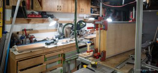

Last week, for the first time in months, I had a free week. For the most part when that happens I have tried to find a project that is fun and small - something with the hifi maybe. A way to escape. This time, instead of an escape, I asked myself what would make my life better.
Drawers were the answer.

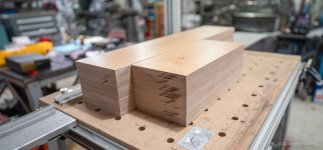

I had three sheets of 18mm baltic birch that I'd been using for set tables (thank you auntie Oprah). They were already sanded and poly'd but if I didn't use them soon they'd get more damaged by the back and forth.
Part of the impetus for this project was the 3d printer and discovering the Gridfinity system. It needs drawers and I had none save for a small Ikea cabinet whose bottoms have sagged to the point of no longer closing. **** Ikea - pretty design that fails any real life stress.
I had sketched out four drawers. The end cabinets always seem to have something in the way that prevents the doors opening fully. And just writing that now makes me realize that I could easily take the doors off and build a full set of drawers to fit...
Squirrel!

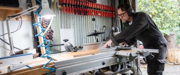

To keep this manageable I decided to make four drawers that would go in the top of the middle cabinets - inside the doors. A halfway solution but one that felt attainable, could contain small things and be done in a week.
I started this process by installing a freshly sharpened blade into the track saw backwards. Surprisingly it cut but burned the hell out of the edge. Knowing something is wrong but pushing ahead is a metaphor for life.
I flipped the blade and cut sheet into the multiples of 190mm which is the number you get when you design them to be 200 and haven't cut sheet in a long time and install the blade backwards.
I measured drawers in the house to see what depth was most useful and it felt like 100-150mm was ideal so I went a bit bigger in case I wanted to add a layer like Sean did and 200, er, 190mm seemed like a good number.
As I was about to start cross cutting the lengths on the miter saw I misplaced my tape measure and grabbed a backup and found that it didn't align with my mark. I normally use only one tape for a project to hedge against errors and so I spent 30 minutes looking for the first tape and when I found it I used my Woodpeckers T-square to make a reference line at 450mm - the drawer depth.
Sure enough the tapes didn't agree and so I pulled all the tapes out and started to check them. Most were good, a couple were out by about 1mm and one, the egregious one, was out by 2.5mm.
Bending the ends brought them into agreement and so I set the miter saws stops and proceeded to cut them all very accurately to the wrong length.
Luckily my error this time was too long as I didn't subtract my 10mm rabbet. Yay, a correctable mistake. My life is filled with those.

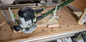

After deciding to just do a 200mm half round cut out at the top of the drawer I knew I wanted to make some kind of relief for fingers since the opening was small. All of my cabinets and drawers have been using the Festool 30 degree round-over bit, probably the first bit I ever bought over 20 years ago when I got my first Festool gear. I loved a tapered edge on a sharp 30 angle. Back then Festool seemed to have a lot of router bits that were all in 8mm shafts.
Now, not so much surprisingly. In fact I only counted about 8-10 bits in 8mm shafts in total and since I didn't want to remove the big OF1400 router that lives in the router table (that uses 1/2" shaft bits) I was stuck with the 1/4" shaft options. Of which there were many. The triangular one on the left was my solution to being able to use that Festool 30 degree roundover (first unboxed on left) but I also got a 1/2" cove. That last one is for trimming laminate so I considered that as well as I prefer bevels to round overs - crisp edges seem more clean.
I used the same jig and did a test cut that was almost the whole depth but left about 3-4mm flat with the idea that I'd round over the front side with the Festool bit.
The depth isn't right as the edge of the bit was cutting into the face but I didn't like it either way. I may opt to put a small bevel on the drawers edge but I may just leave it.
Since I'd already glued up two complete drawers I needed to be sure that whatever way I route these would work with the built up drawers so I checked to be sure the router would fit inside the drawer and it did. Confident with my tests I ran the router over the two fronts of the unbuilt drawers...
I'm not sure why I'm burning the corners, I suppose it's because I'm slowing down and trying to not to mess up the returns but part of me isn't actually that bothered by it.
I clamped the jig to the completed drawers and ran the router over the cut outs with out much drama. Festool is famous for its dust collection but I've found the both the router table and the router itself are pretty bad at collecting the sawdust - rout-dust? I'm not sure any of it gets picked up and the floor and myself were covered in sawdust.

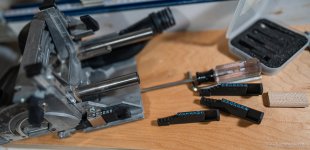

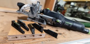

The Domino cutter is another tool that I have not used in... years? It was another small revelation of "wow, this is such a cool tool, I should get one of these... oh, right, this is already mine! How cool is that?" Can I just say that with rare exceptions I don't think I ever regret buying tools - even ones that I don't use much.
I took it apart to change the bit to the 6mm size and noticed that I had a Senaca Woodworking plate. I bought this right after getting the Domino because it was supposed to allow you to center the bit on 3/4 plywood - and maybe it does but you have to use the Domino upside down which was awkward. Also I am always using 18mm baltic birch and 3/4" is closer to 19mm. So a fail all around.
This reminded me of how useless the built in Domino depth stop is: 16mm, 20mm, 22mm, etc. and none are remotely related to... anything? 16mm is almost 5/8" but who uses that? 20mm? Beats me. Everything that I do is 12mm 15mm and 18mm.
I looked at that depth stop and thought, "Hmm, not that complex - it would be a pain in the *** but I could certainly machine a new one from aluminum. It would take at least a day..." Then I removed the bit to measure the threads so I could make a dummy bit with a point to help me measure center but I didn't have a 6mm x .75 tap...
"It's been years now - surely someone has solved this already..."
Searching "Festool Domino DF500 Depth Stop" and what do you know...
The 3d printing world provides and the usefulness of the Bambu only grows. At this point Nadia and I use the printer more than Lucas.
