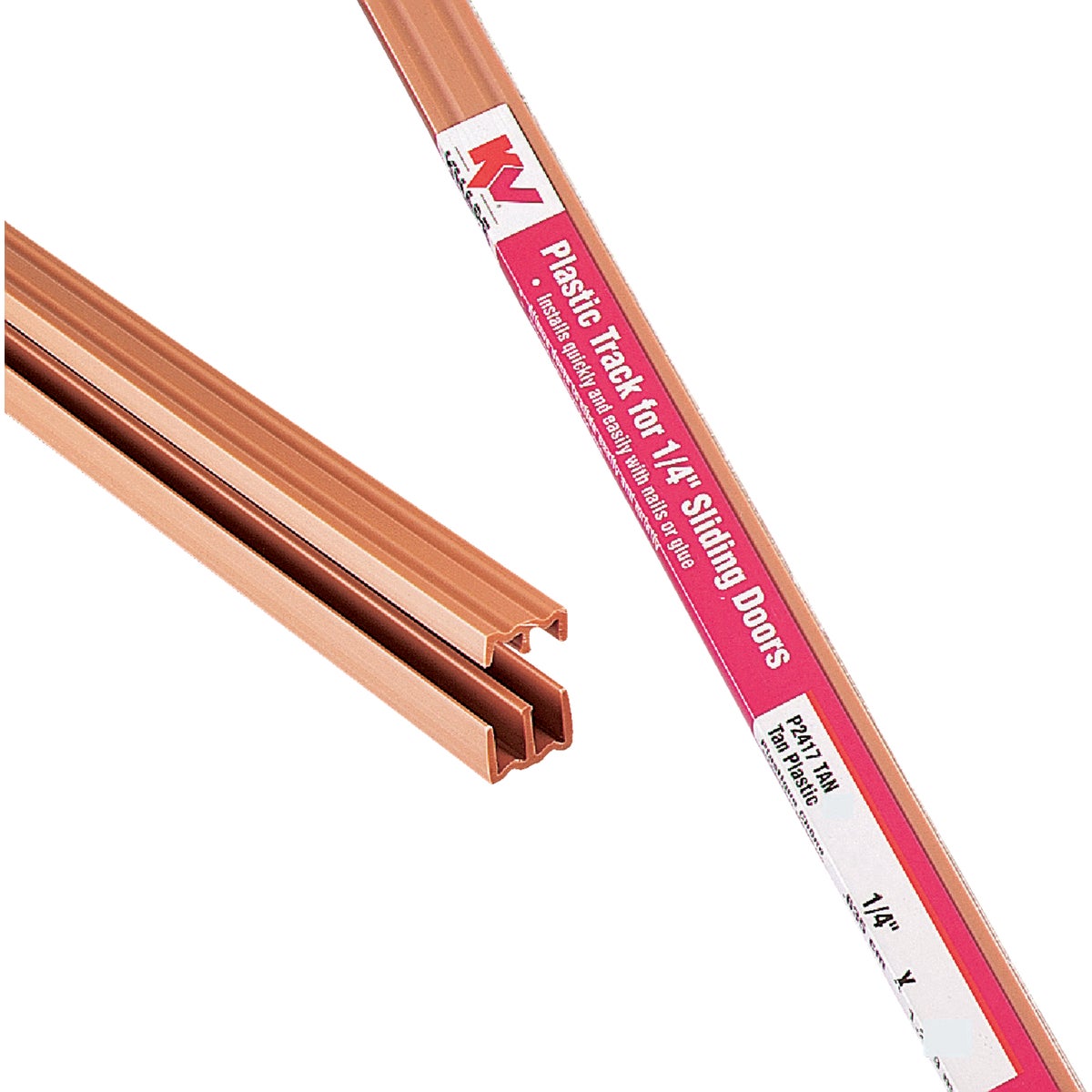

So, with the lag screws in the top side, anyone have any ideas on how to instal the sliding doors? I'm thinking a 1x2" trim piece, with holes or recess to fit the lag screw heads and then the plastic sliding door trim. Thoughts??

I finished the one side of cabinets, with the exception of doors and paint. I added the end panel and one panel in the middle of the first section for strength. I read a few posts on here about cabinets being supported by the sides, and it finally clicked for me. With the panels, it's way stronger.
Also started on the other side.
The workbench will sit under this and in the corner.
And the soffit will extend to about 12 inches short of the chalkboard
