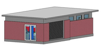

Hello! I've been a lurker on this site for a while and have really learned a lot. I thought it was finally time to share.
Now that construction has finally started on my new garage, I finally feel comfortable posting about the project. Last year I moved from a townhouse into a new home with a nice size backyard. The house is wonderful except for one minor detail: it has no garage. In the Townhouse I had converted the standard two-car garage into a workshop for my Mini Cooper Racecar:

I wanted to create a workshop that gave me enough room to work on the car as well as room for a variety of metal fabrication tasks - both for the car & other projects/ideas I have. I went through a very large number of design iterations - some by choice, some forced on me by others. For example, the city threw a major wrench in my plans a couple of months ago when they informed me I couldn't build where I wanted to because the buidling setback was 25' instead of 5' (because I was next to a major thoroughfare)!! That forced me to "flip" the design to the other side of the yard.
Here's what I finally came up with. The design mirrors the design elements of the house (flat roof, overhangs, courtyards, etc.):
One half of the building is focused on "clean" work with the car; the other is for the "dirty" metal fabrication & welding. In between is storage cabinets. I've kept the design flexible so that I can easily rearrange things.
For power, I'm running 110 & 220 outlets along the front & back walls, and I will have a total of 200A service just for this building. I will have at least 5 dedicated 50A 220v circuits for welding & heavy equipment (Mill, Lathe, CNC plasma cutter, etc.).
For lighting I'm using 8 4x4' T8 fixtures & aiming for 100 lumens/sf. I will also have separate task lighting over the workbenches.
The walls will be covered with hardiplank sheets laid out in a brick pattern. The ceiling will be drywalled.

Nice modern design, I like its style.
I would spin that garage 90 degrees, along the back property line so you can stretch the garages footprint with the goal of adding another bay to the design.
This will also allow you to view the doors from the house and block the publics view from the street.
Adding some height to the structure would also allow you to have 2 cars in one bay, one on the lift, and one below.
NEVER forget to dream and GO BIG! Get everything you want.
Once the cost estimates come in, think what you can live without...only then, should start being realistic.
Think how you can keep those items you want, or at least have in place for future installs, when your more cash happy.
I was so glad I layed pipe to remove overhead electric wires in the future....last year I use that pipe to make it happen, 7 years after the garage was up.
I am glad I layed gas line too...it took 2 years after I built the garage to afford to use it.
I am sad, I didn't run 100 amp service, coax, telephone, cat5, and a water line.
Guess what I am saying is ...plan for the future!!!

Thanks for the positive responses!
Here's some photos of the foundation construction. It's a pier and beam 5" (thick) concrete slab. The piers go down 10', and the beams are at least 2' deep. It is easily strong enough to handle any equipment I want to place and/or adding a second floor in the future.
BTW This also shows how high the fences are in the back. The side fence facing the street is 8' tall & the back fence is 12'. The previous owner installed these to mitigate street & freeway noise/lights. I'll probably have to fix/replace them in the near future (they're falling apart).

Great thoughts/feedback. It mirrors the way I've been thinking about it. It's a bit hard to see, but in this placement I can add on either to the left (towards the house) or right (in the back). And I've designed it so that I can add a second floor in the future.
FYI because of the fencing & placement you can't see the whole building from the street....plenty of privacy!!

Great plan, but mostly, what great renderings - those last couple in the first post are almost like you are standing in there looking at the finished shop. What software did you use and did you spend a lot of time creating it?

I'm lucky enough to have a copy of Autodesk Revit to play with. It wasn't difficult to generate the renderings once I found models for the tools, lift & car. There's a lot I could do to improve the rendering; the reflectivity & materials aren't really right...
I'm thinking of making some additional models myself for the other tools I couldn't find (e.g. Mill, Plasma table, etc.). That would really help me to refine the tool layout & storage plan...

Slight design change
My house has steel I-beams as lintels above several of the doors & windows. I was planning on doing the same over the double glass/aluminum entry doors to the garage. The GC pointed out that with an 8' height on the brick that wouldn't look right. So I modified the design slightly to bring the brick on this end all the way up. Here's a quick rendering I did of the change:

Styling details
This is an example of one of the steel lintels in another part of the house that I'm mimicing for the garage. These were installed in an earlier remodel of the house where they opened up additional windows & doors into the brick siding:
For the interior I'd like to create the effect of a refurbished industrial feel. For the floor I'd like a simple clear coated epoxy coating with a bit of color similar to this:
And as I mentioned earlier I'm trying an experiment for the walls: sheets of smooth hardi-board screwed to the wall in a brick pattern. Imagine something like this except solid colors:

"And as I mentioned earlier I'm trying an experiment for the walls: sheets of smooth hardi-board screwed to the wall in a brick pattern. Imagine something like this except solid colors:"
I think it will look very sleek; right in keeping with the overall design. Those panels kind of remind me of the old enameled metal panels they used on some gas stations, dealerships, and some other types of businesses in the Moderne motif in the post WWII era.

Updated Tool Plan
I've gone back and revised the tool layout plan a bit. I've moved the interior column to 9' from the back wall and shortened the partition to 7', enabling me to fit exactly 3 3' wide cabinets on each side and a 4' wide cabinet on the end. And I can use the area above it more effectively for large-item storage.
That also gives me a bit more width to roll stuff between the sides. I think I can get it so that I can roll a gantry crane almost everywhere if I can find one the right size (or make one).
I'm now going through and planning the contents of each cabinet (e.g. tools, small parts, large parts, etc.). The cabinet on the end will be perfect for small parts storage (i.e. tons of little containers).

Great plan although I'd also go for more height if possible. The rendered pictures are sensational at showing the full layout. While possible I'd lay some audio cables through the studs for inbuilt speakers.
Do you have a place for the beer fridge?:thumbup:
