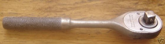

Tool Pants
Oct 4, 2008
1,249
San Jose CA
Some time ago I saw on ebay a double headed Proto ratchet made for Vogel, 3/8" and 1/2" drives. I checked here to get the scoop. Then another one showed up on ebay and at the same time, the one with dual 3/8" drives.
I got sniped on the dual 3/8" but won the Vogel. Seller says it is in very good condition and shows little signs of use, so I hope when I get it and take it apart I do not see broken teeth like billymade.
I can understand the 3/8" x 1/2" Vogel. I do not understand the reason for the dual 3/8".
48548
May 14, 2008
4,033
Phoenix
I was going to bid on the dual 3/8 the other day, but didn't really see the point of it, and instead bought two 5248s protos, the 1/4 body with a 3/8 head, as i like to know that I have tools that have a purpose and the dual 3/8 didn't make any sense to me, and would also cause it to stick out even more.
Tool Pants
Oct 4, 2008
1,249
San Jose CA
I received the Proto for Vogel today.
Weird. No signs of it having ever been used. May take it apart this weekend to see what is inside.
Did Plomb have this dual head style?
How about Urrea for both styles?

Tool Pants
Oct 4, 2008
1,249
San Jose CA
Here it is apart. Typical Proto design with 24 teeth. I see no signs it has ever been used. The gear and the dual drives are chrome plated. Think I'm going to contact the seller to find out how he has a new old ratchet. Maybe because it was weird the owner never used it....
It came with the 3/8" drive facing the shift lever, like billymade's picture. But as you can see from the last 2 pictures it can be assembled either way.
Now I need to find the dual 3/8" drive version.
For billymade, check out Urrea and see if they have a replacement gear.

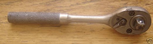

Tool Pants
Oct 4, 2008
1,249
San Jose CA
Proto for Vogel. I did ask the seller where he got a new old ratchet . An estate sale he said.
One drive for metric and the other for inch.
Belive it or not.

Tool Pants
Oct 4, 2008
1,249
San Jose CA
3 months late, I'm really going to see double. Just won on ebay the Proto 3/8" double drive version. Thank you Mr. Vogel.
The plate on this one has a standard Proto/Plomb 5249 part number for a normal 3/8" drive.
When I receive the 3/8" x 3/8" I'll take it apart. It does not look to be in the as new condition as the 3/8" x 1/2" Vogel. Pictures are from ebay because I do not have it yet.
