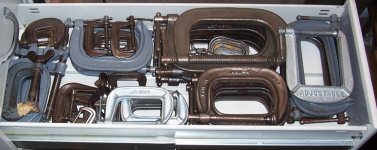

This is what you are looking for:
(This is about 1/2 my C-clamp collection.)
