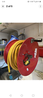

After looking for an original USA Rapid Reel I finally snagged one and it's on it's way. They are tough to find in red as I wanted one to match my brick exterior.

I'd like to do a red matching shelf above mine as well. Wondering what brand/model you have in the second picture?
