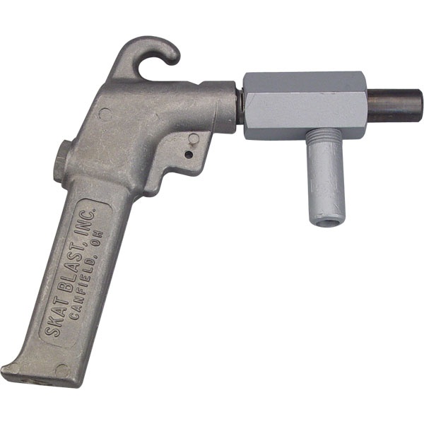

Inside will have a piece of 3/4 expanded metal for a grate.One of the things i need to figure out is some kind of support for the middle of the grate,i will be putting fairly heavy items in this.
Things i want for this.
Alot of light.
I'm using a TP tools SKAT GUN
I plan on building a spinning table for the center, 24" diameter.
And i'm still on the fence with vacuum.I have almost all things needed,just working out the details.

A) What gun, trigger or foot control? ,leaning toward foot.
B) the vac set up.I have a few different ways to go with this.I have a couple of large shop vacs,I have an old Craftsman dust collector,and I have a few other things I'm considering.
Of course what matters is that it works properly without having to adjust,clean,kick,scream at every 4 minutes.BUT, the biggest seller to me right now is noise.I'm so tired of listening to a shop vac run that has had tons of grit through it.I swear if a shop vac were my only option,i'de bury it in a hole in the back yard and pipe it with pvc.

Well today i ordered my gloves and rings for the box,next on the list is a gun and a pedal.What are the advantages and disadvantages of a steel tip vs a ceramic tip guns? I imagine one wears quicker than the other,but is that it? Also availability of consumables is important.I don't want a gun that i can't get tips for in a year.
gtermini
Feb 1, 2013
533
Amity, OR
Find a gun with a carbide nozzle available. The carbide nozzle should almost outlive your cabinet. I have a speedaire/campbell hausfield in mine. I bought the carbide nozzle from Grizzly tools for it for about $35. I think I'm going to upgrade to a TP gun in the next little while. They have a full line of parts available at a reasonable price. I want more volume and I already ported the body of my current gun out. Buy the biggest model your compressor can run. My compressor is just under 20 cfm with a 60 gal tank, and it runs way less than half the time when I blast steadily. I made some internal air nozzles on the lathe out of 5160. They are a simple turning job and hardened them as hard as I could get. I found internal nozzles hard to find for the cheapo gun. With glass bead, I haven't noticed any wear yet in maybe 20 hours of blasting. The abrasive you use will determine the nozzle life.
Don't cheap out on the pedal air either. Get one that will not be a bottle neck in the air flow. I bought an Air-Mite with 1/2 NPT ports. Expensive ($200-250) new, but I found one NOS on feebay for about $75.
Greyson
I've been looking at a lot of stuff.I have about 200 to spend on a gun and pedal set up,i can go more if i have to,but prefer to cap out out the 200.I'm looking for those kinds of deals,a 200 dollar item for 75 or 80 bucks.I will take my time and look,but i really do wanna get something in the works and pull the trigger on the order.
thanks on the 1/2 npt info,good to know.I'm guessing it has worked well for you?
gtermini
Feb 1, 2013
533
Amity, OR
Sent you a PM about a pedal.
This is the gun I'm thinking about getting
It included the carbide nozzel all for $130, eats 25 cfm. Even if your compressor doesn't put that out, as long as you are 16-20 cfm, it should be fine.
Be sure to get a good filter and regulator to stand alone for the cabinet. I mess with the pressure all the time depending on what I'm blasting. The foot pedal is nice to vary the flow too.
Greyson
