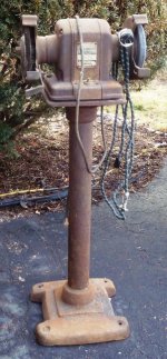

CL ad.
Brought it home for $20.
Close up of tag/label. I make it out to be a 1/4 not 3/4 HP. Looks like 1 61 on lower RH, manufacture date probably.
No date stamp on bottom cover, no capacitor or start-up relay; but 3-wires leading towards windings. Probably it uses a start-up switch to enable/power the start-up winding. {Later pictures reveal the 'white' wire does lead to a start-up winding switch.' A second 'white' wire [not visible] runs from the other side of the switch to the start-up winding.}
I removed the RH grinding stone, performed a visual inspection - no cracks. Performed a 'ring-test' - failed. I broke the wheel apard before disposing of it in the trash. Still no signs of a crack, but it did have a semi-hard arbor bushing. I wonder if that is why it failed the 'ring-test'? It sure as hejj 'rang' when it was hit with the hammer before it broke apart.
LH wire wheel removed. Note: the inner flange was on backwards, and a brass fitting was used as a spacer. Also the wire wheel's crimped flange was loose. :wtf:
Continued in post #36, below.
Thanks for looking. :)
Comments and suggestions are encouraged.

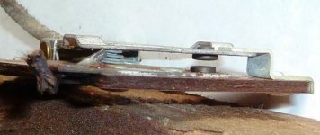

Picture of switch screws removed and second 'white' wire cut at the switch, to allow removal of winding/core assembly.
Rotor, centrifugal weights, and start-up switch after RH casting was removed. LH bearing is still on arbor/shaft, RH bearing has been removed from arbor/shaft.
View of arbor/shaft, LH & RH bearings, start-up switch, mounting screws, and CM ignition wrenches.
Start-up switch detail. Second 'white' wire was connected at top terminal, some wire and solder is still visible.
Side view of start-up switch, showing contacts/points in the 'Open' position, which de-energizes the start-up winding at about 3/4 of operating RPM. Normally, at rest/start-up, the contact/points are 'Closed', which energizes the start-up winding.
Detail of centrifugal weight assembly that opens the start-up switch.
At rest the black plastic bushing is extended, note inner spring. The bushing presses on the start-up switch, closing it's contacts (just like breaker points) which electrically connects the field winding (white wire) to the power cord neutral wire.
As the rotor spins-up, the weights swing out against the force of the small diameter springs (1 on each side). At approximately 3/4 of the machine RPM, the bushing is pulled away from the start-up switch, opening the contacts, opening the start-up winding circuit, and de-enrgizing the start-up winding.
Note: this picture is of the rotor assembly from a 1/3 HP CM Model 115.7566 Manufacture Date: 2 59.
Continued on next post, below.

Continued from previous post, above.
Bearings - outer face.
Bearing detail [inner face] showing numbers. Outer number is Z97502. Inner number is N D 3202.
OD = 35mm
ID = 15mm
Width = 11mm
