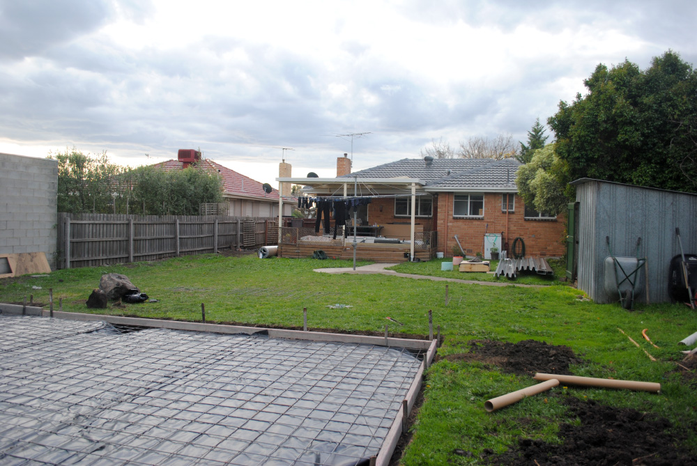

So my initial plan was to dig it out, get some material in and do the form-work with my mate, then he would source a concreter friend of his to do the pour and screeding. Unfortunately after the digging we went through much back and forth before succumbing to the fact that it was going to take a hell of a lot of time (we can only work Saturdays when we are both available), and we were also struggling to lock people in to do the work.
In the end I called up one of the concreters that I had quote the job initially to save the day. He came over and had a look at the site again and agreed to take the job on. This was on a Saturday, and luckily for me he had a job cancellation and was able to start that Monday! I ended up saving a bit of money from doing the digging so it wasn't all done in vein.
Within a few days, this greeted me on my return home from work one evening...
(bar chairs not installed yet)
Then a week (or two) later, this happened...
Unfortunately the truck was too big to get down my narrow driveway (damn old houses!), so he had to crane everything onto the front yard. Not wanting to leave all of those valuables on the front lawn, I went about carrying the whole shed to the back yard, one piece at a time. That was definitely not a fun exercise.
I wanted to put as much material as I could on the deck to keep it out of the weather, but after a while I realised that it was probably too much weight for the poor thing, so the longest parts were put on the lawn, using some wood to keep it off the ground, then covered with plastic.
Roller door was delivered separately for some reason, but the guy's truck was really cool, and old 60's era International, should have taken a pic.
One last view of the site from the back corner.

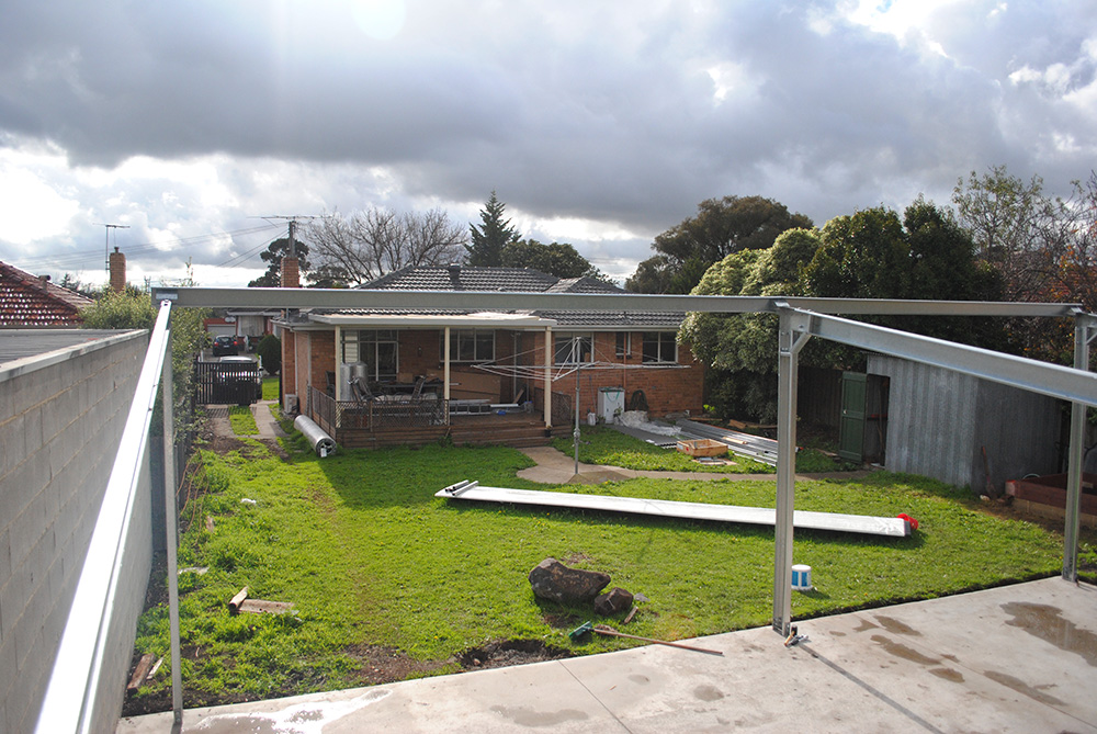

Slab done :) Now I just need the thing built. The people I was going to use might turn out to be a tad expensive, so I'm going to do some ringing around this week.

So this weekend we decided to give it a shot, and I have to say things went very well, we did half a day on Saturday with 4 of us, then myself and my dad buttoned up a few things this morning. We now have the main columns and rafters up.
Next Saturday we'll hit it again (weather permitting) and hopefully get majority of the framing up, at least the mullions for the roller door. Very satisfying!
Might still get someone to do the roof cladding, we'll see how we go. It's great to get a proper feel for the size now, it's a bit larger than I anticipated!
