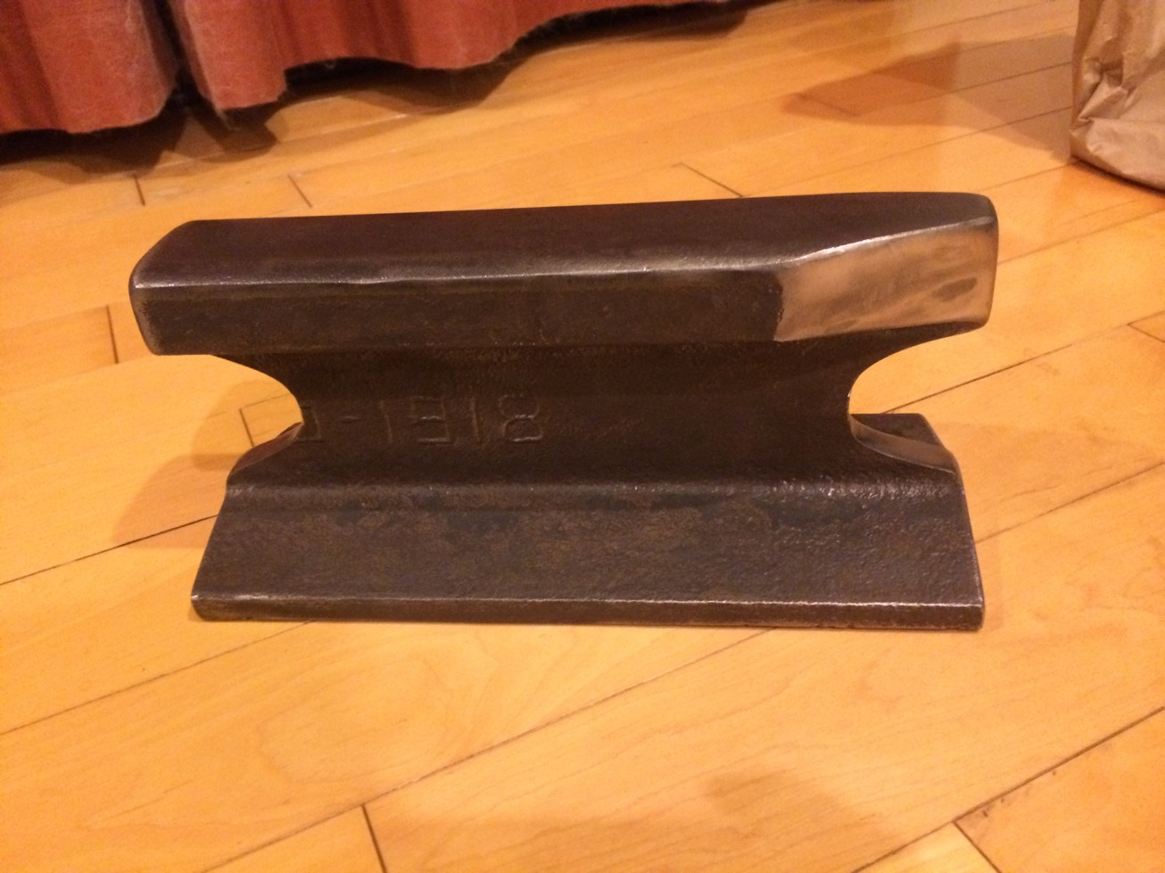

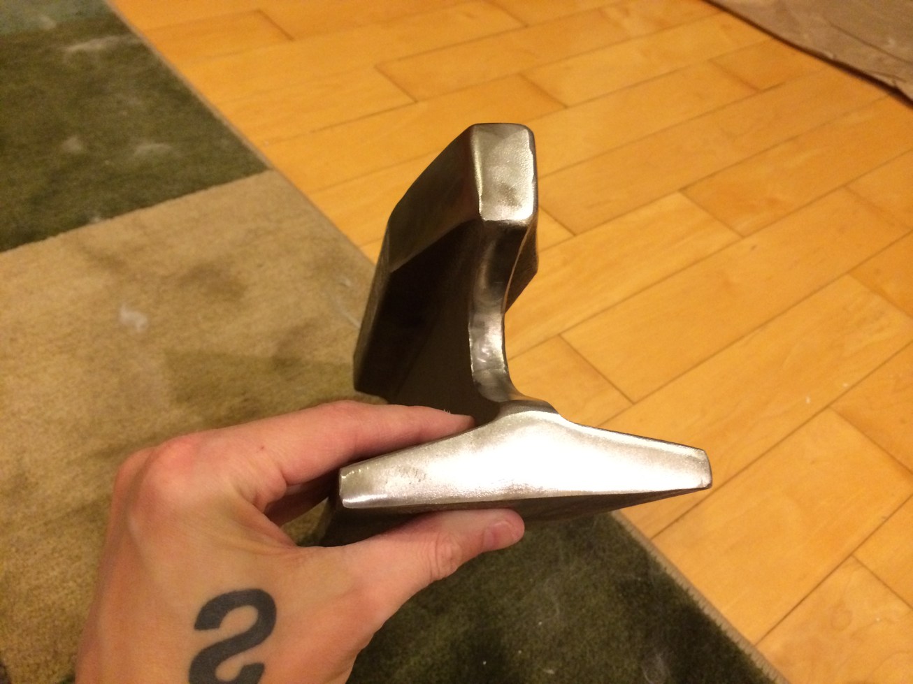

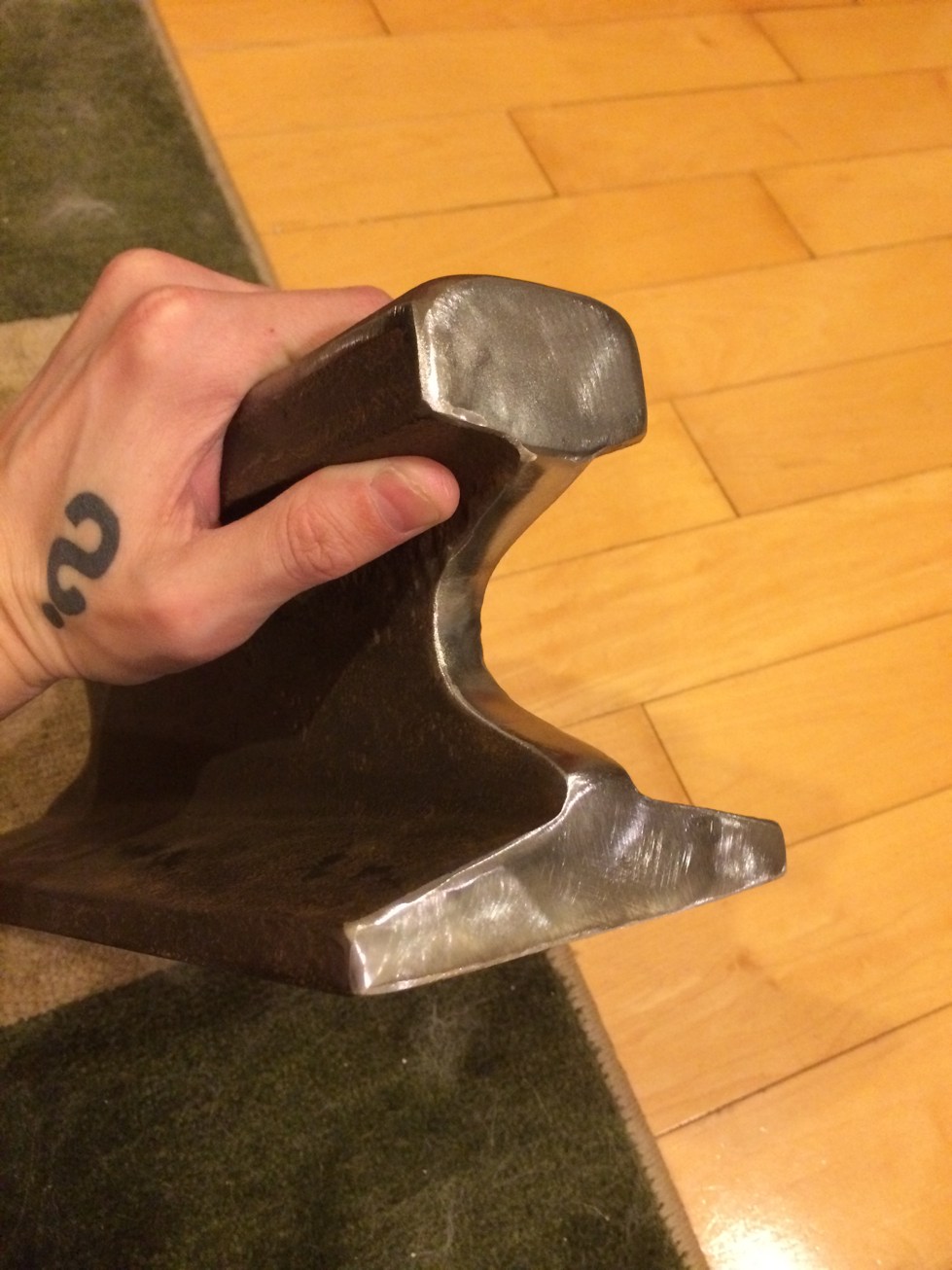

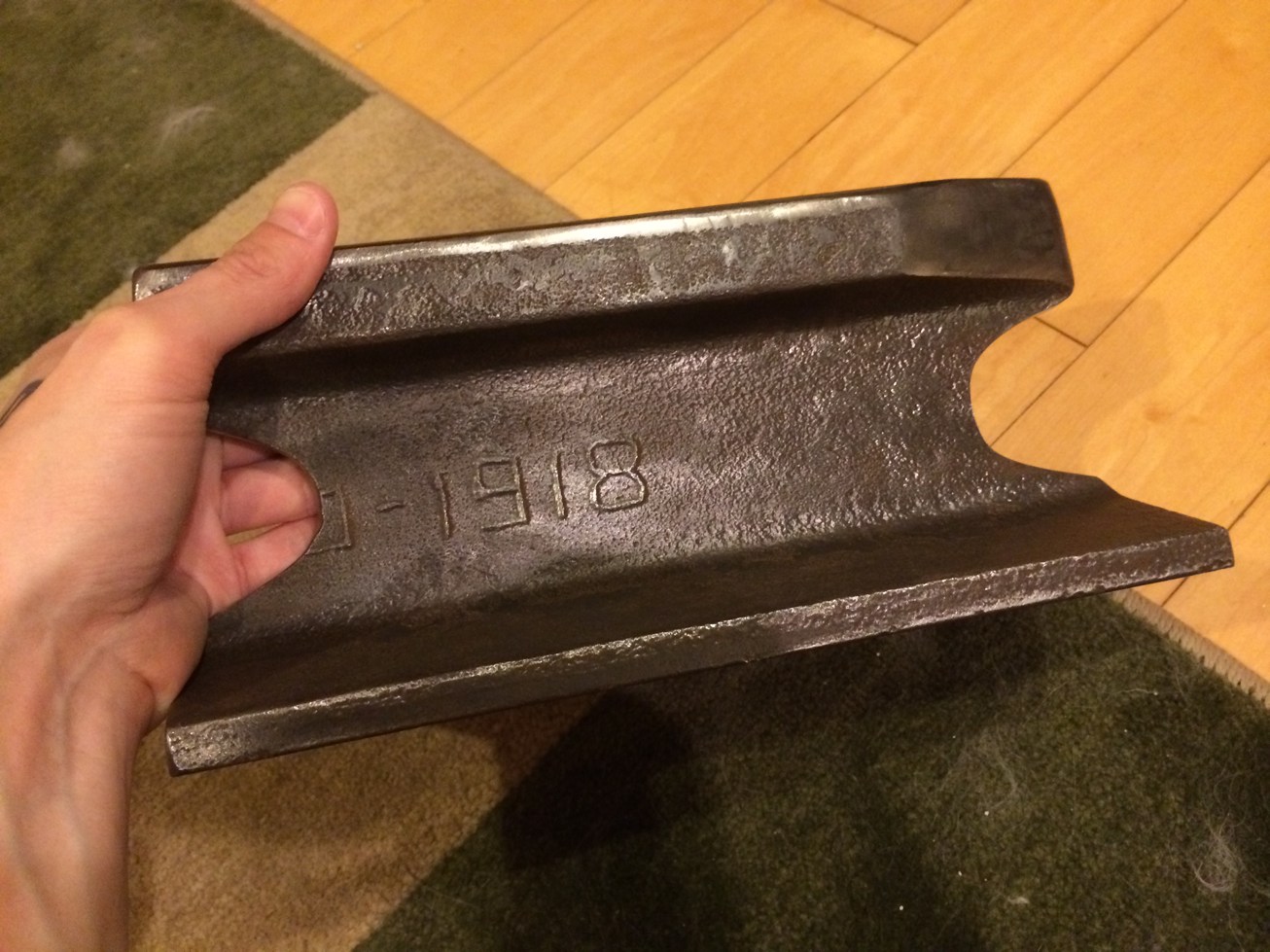

Hi all-
Just wanted to share some pics of the rail road track anvil that lotsoftools was nice enough to craft for me. Just received this in the mail--got to love flat rate USPS boxes!
It has 1918 on the side, which is a sentimental year for me.

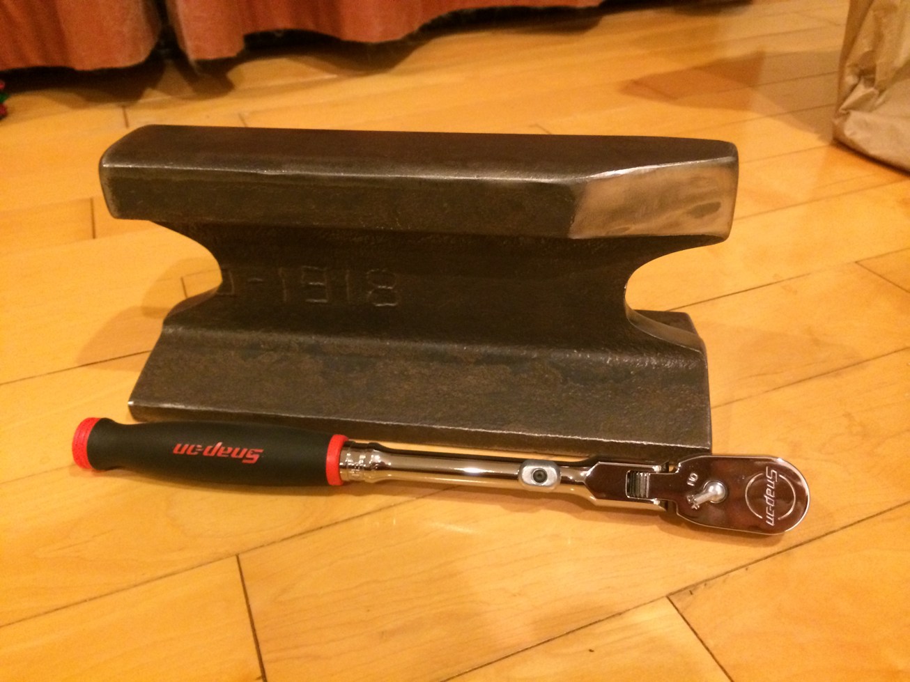

Next to a fhx80 for size comparison.
I had never heard of people making anvils out of rail road track before, but what a cool idea and great way to reuse steel that would otherwise be sitting unused!
