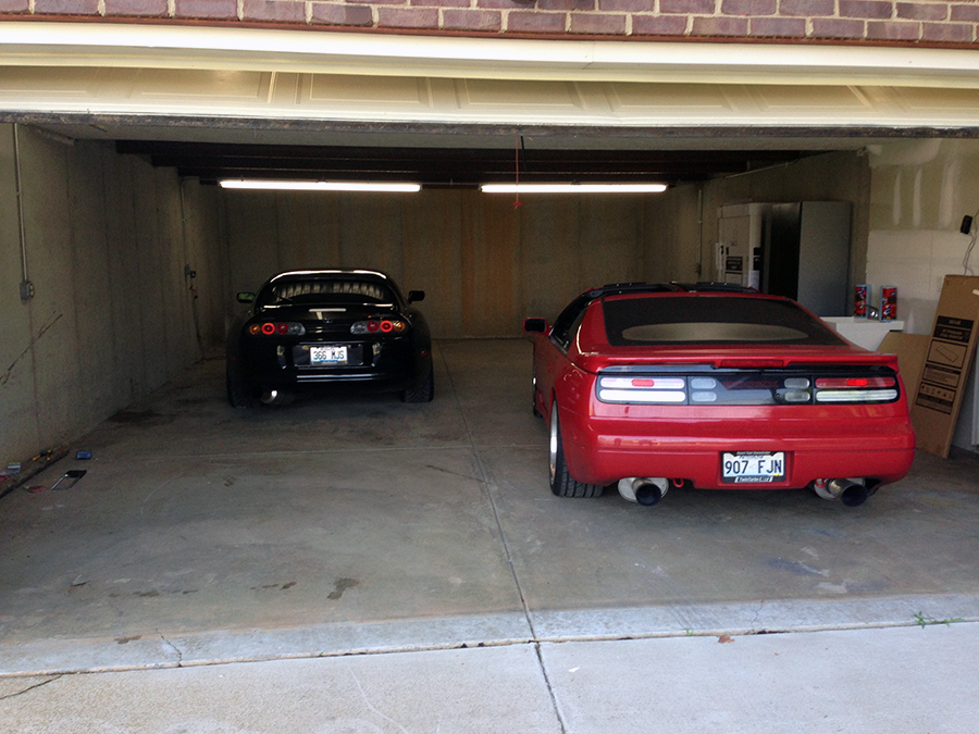

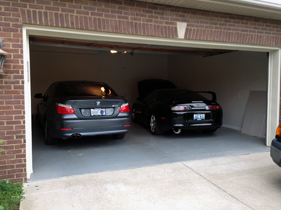

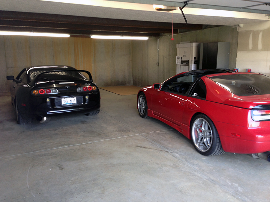

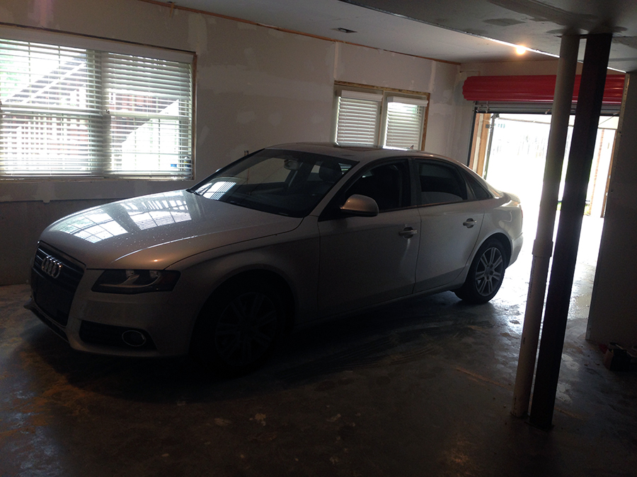

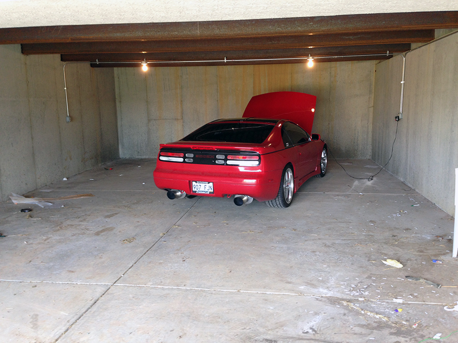

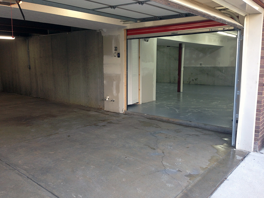

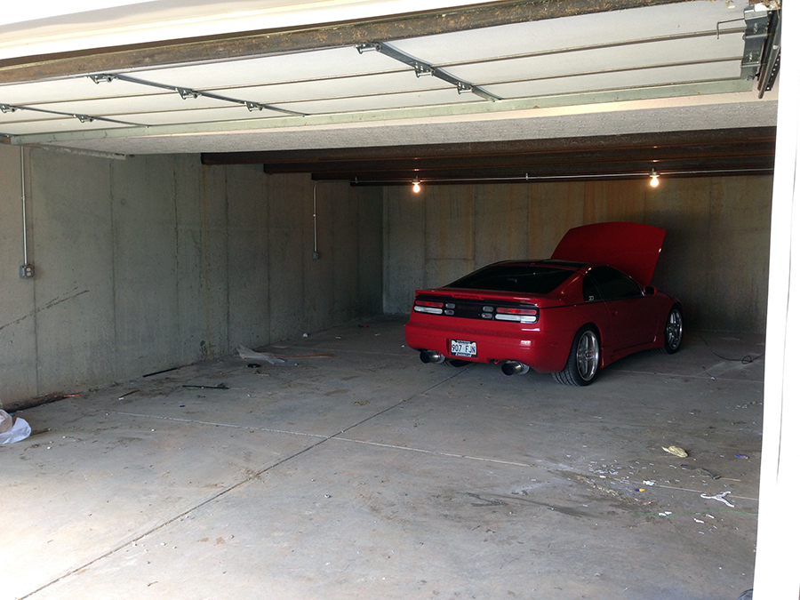

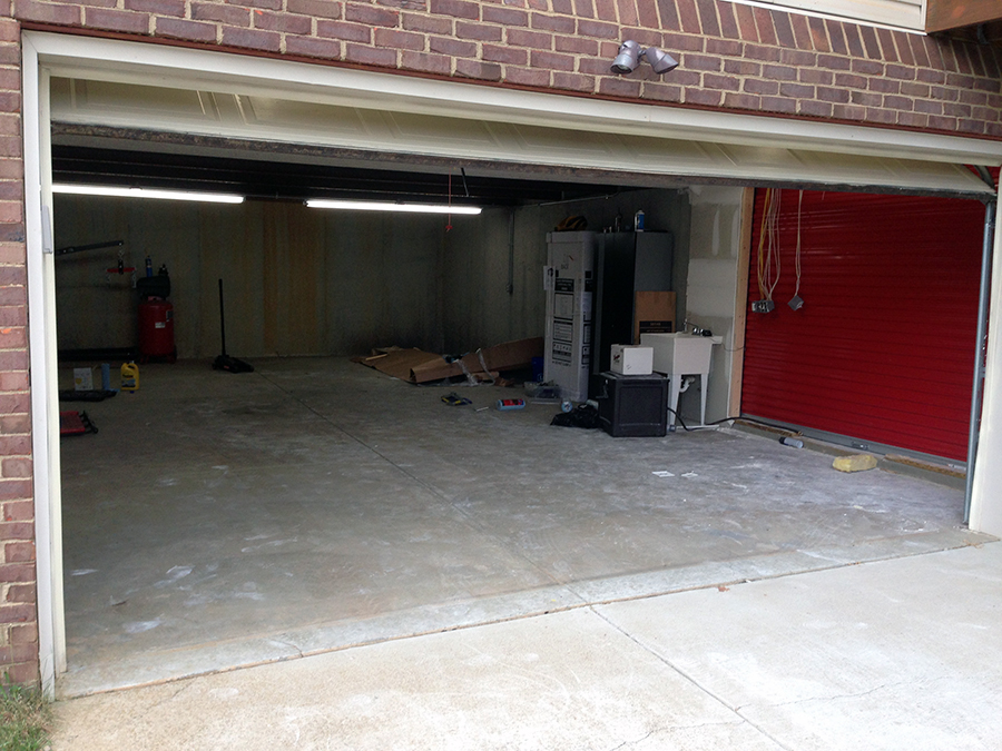

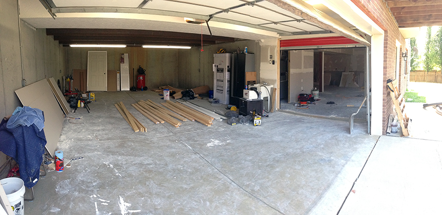

For the last decade plus building cars has consumed a good portion of my time. It started out as a hobby / necessity and then grew from there. My old house was a standard two car garage and wasn't cutting it anymore from a space standpoint. This spring I found my dream home (within reason). It has a two car garage upstairs and a 4 car garage down stairs. Next to the 4 car garage was an unfinished basement. I knocked out the wall between them and started renovation.

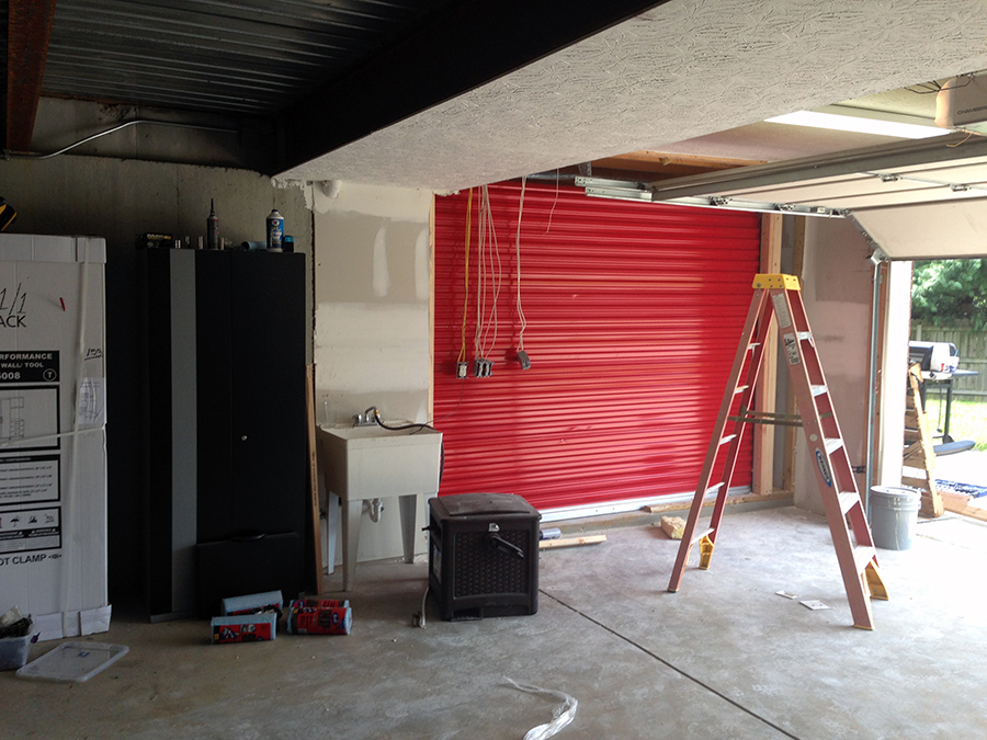

The house was in foreclosure and had been neglected to say the least. Here are some pics from day 1

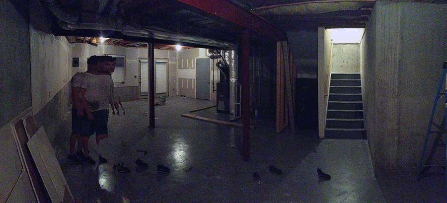

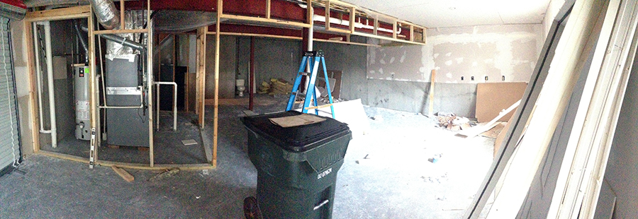

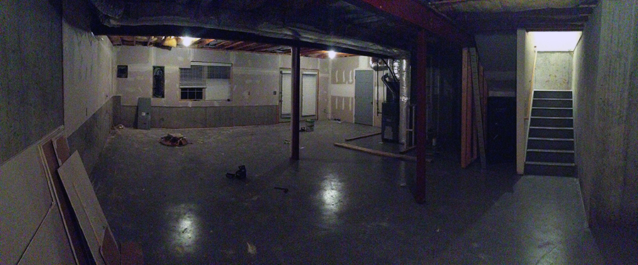

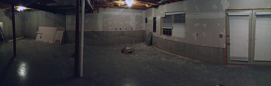

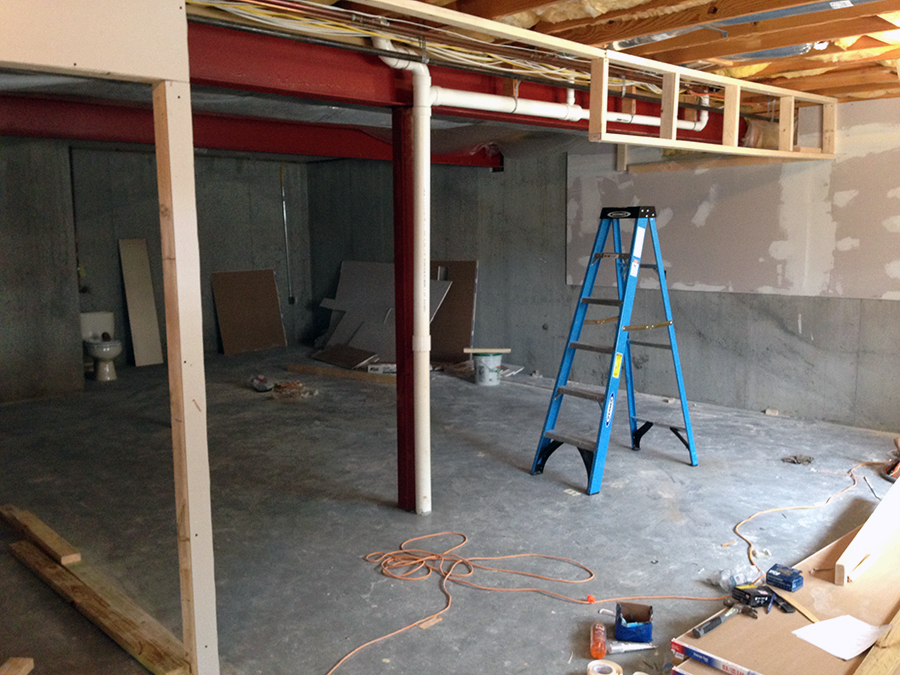

And here are some shots of the unfinished basement
During this time I had to fire two seperate construction crews for just not showing up and or doing terrible work.

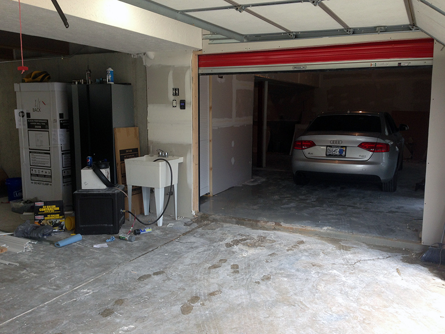

Next step was to add a door between the downstairs garage and the basement
Time for a test fit

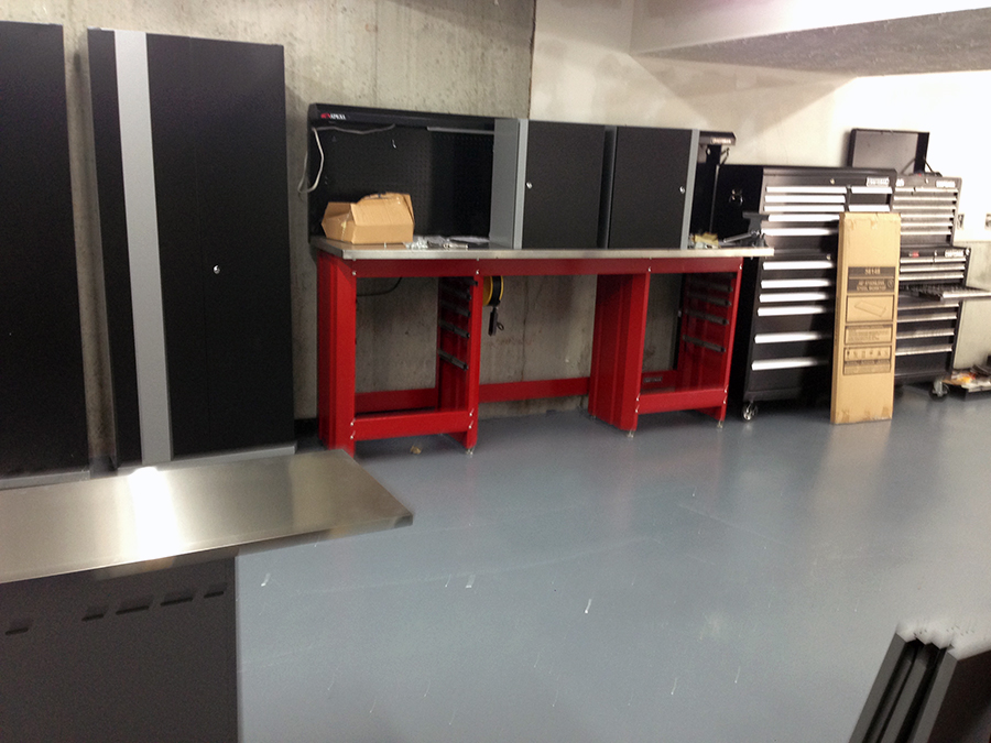

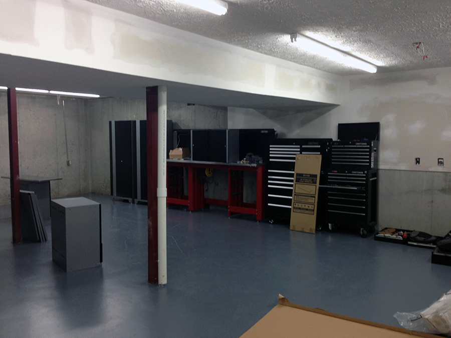

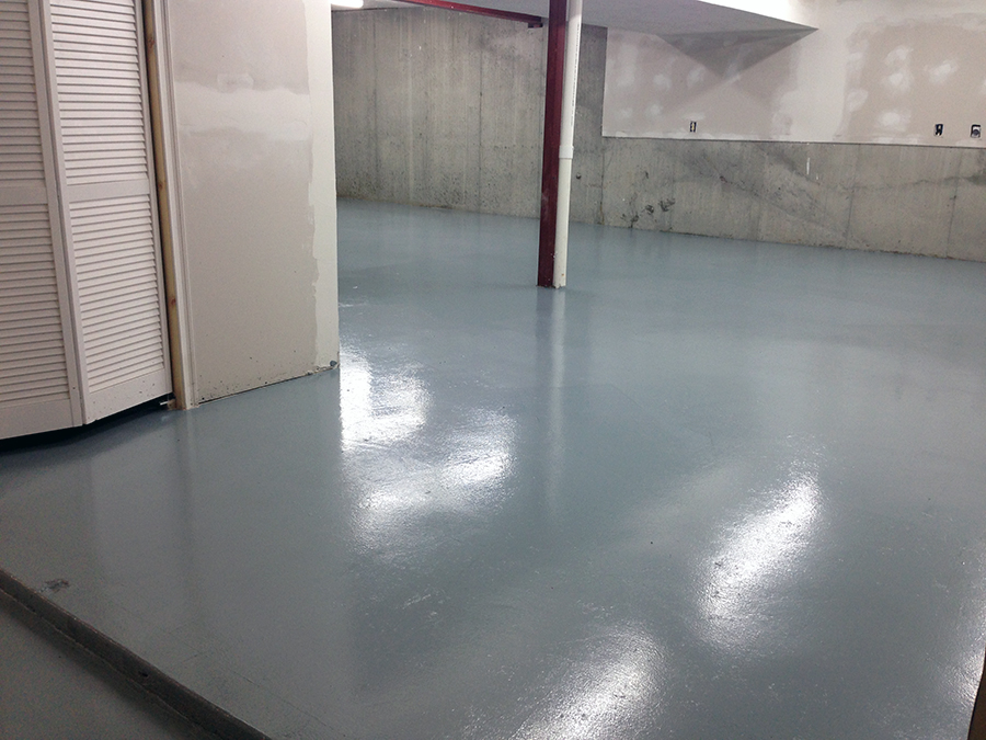

After a lot of research I decided to go with Sherwin Williams Tile Clad for the floor
Some of the tools test fit

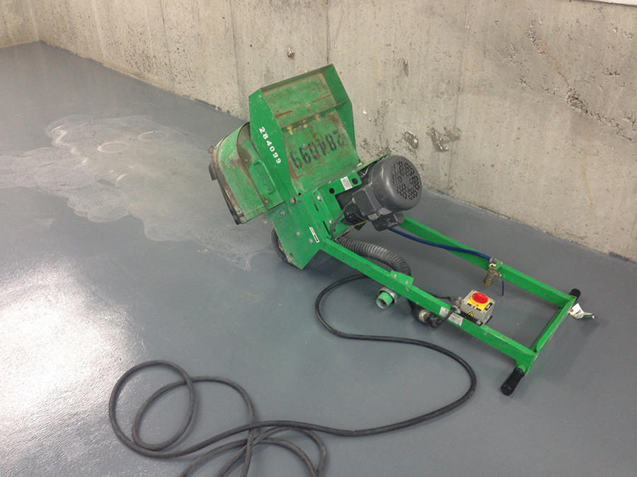

When Sherwin Williams mixed this epoxy they got the color wrong...in an attempt to fix it they added more colorant which ended up messing up the chemical reactions and the floor never cured correctly. They attempted to fix it and this process drug out over 7 weeks. In the end they just refunded my money and we parted ways. They handled a bad situation very well.
So at this point I am behind schedule and no longer trust / want an epoxy.

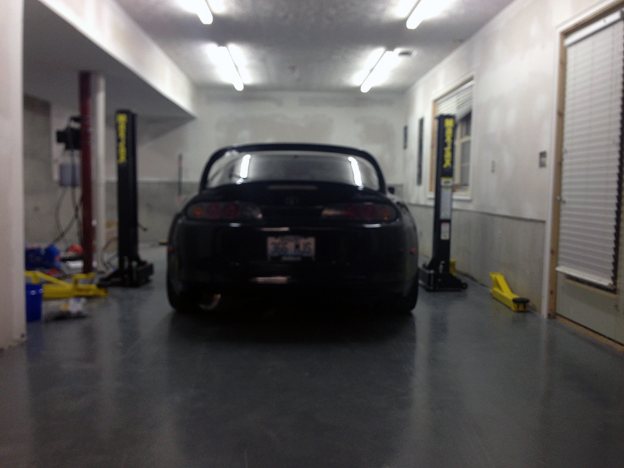

I was always a big fan of Jack Olsen's garage so for round #2 decided on tile. I ended up finding a great deal on some LEA tile but I had to buy more than I needed to get the price I wanted. Once I am done using what I need I will just sell the rest.

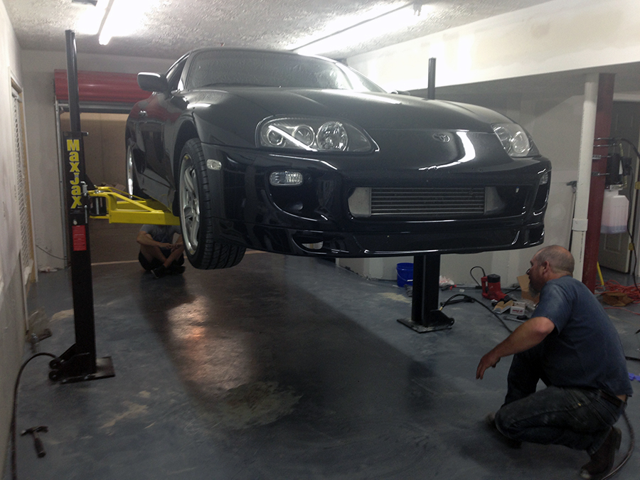

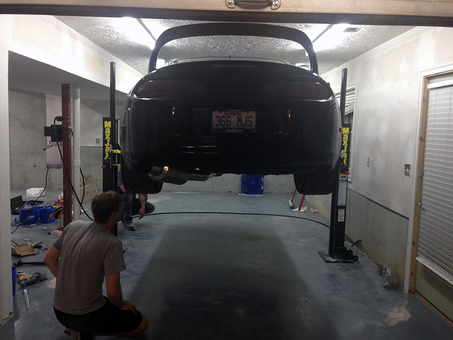

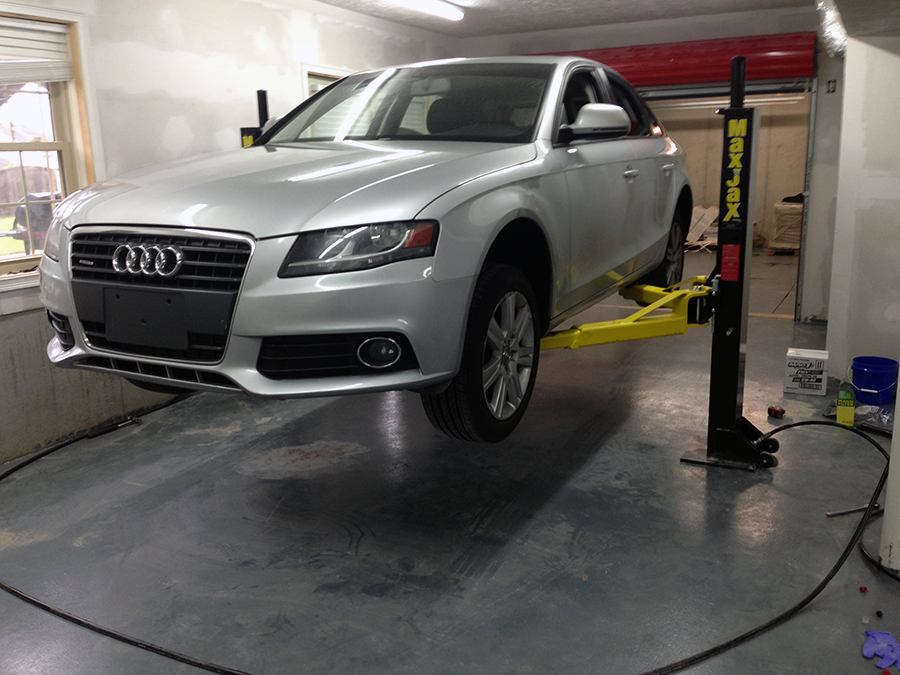

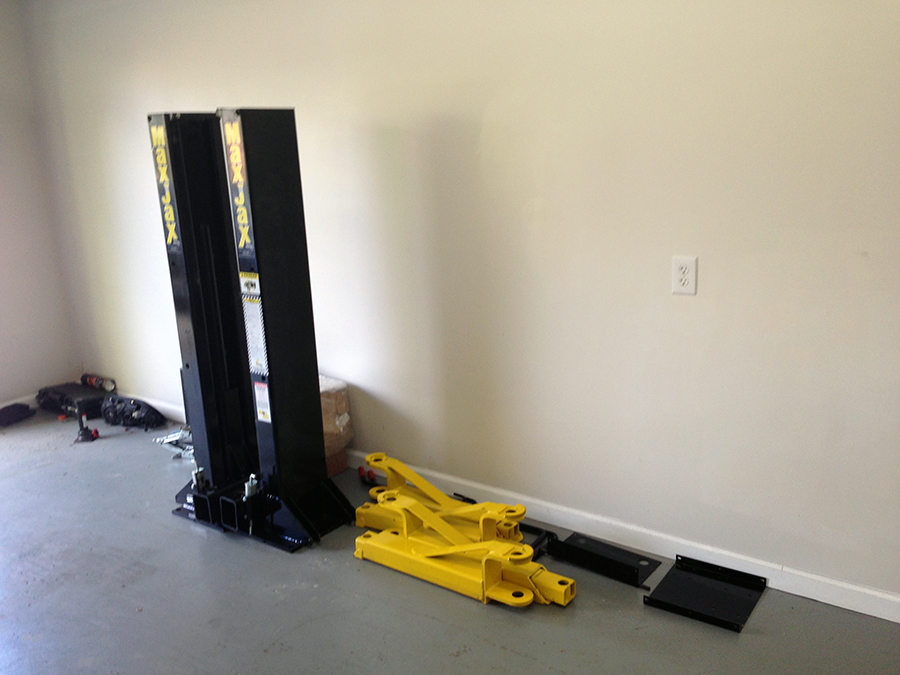

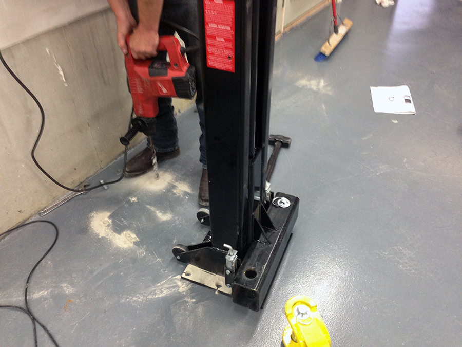

Next step....car lift. Due to the low ceiling height I went with a Maxjax. At this point I couldn't be happier with it! Here are some pics of the mockup / install.

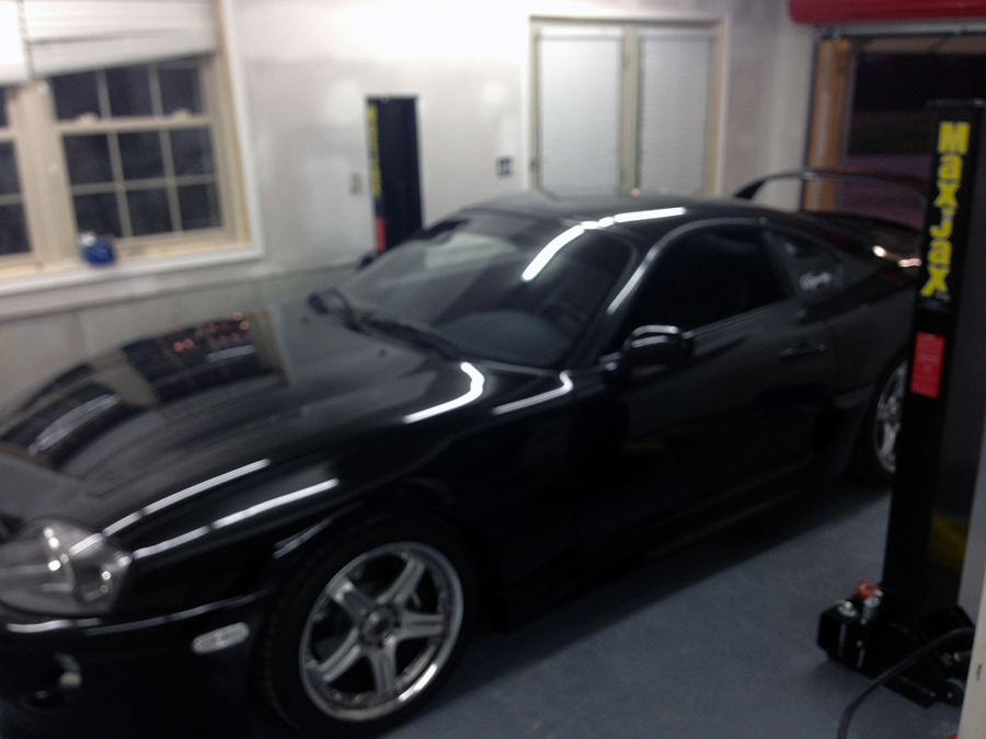

Maiden Voyage
Knocked out a quick oil change last weekend....love having a lift.
So now the game plan is start laying tile late this week / early next.

Are you going to lay tile over the epoxy?
Not assuming you don't know it but if the epoxy hasn't cured then you need to grind off the epoxy and then lay the tile. You can use the stand up type grinder that looks like a floor buffer; it will grind off the epoxy and give the floor some grip to grip the thinset.
Madhatter10-6
Feb 27, 2013
305
Lexington, KY
Nice place, great find!
Thanks for bringing that up!
The first layer has been down for 2 months...and the 2nd over 1 month.
I was going to grind it off but after renting a grinder and trying two different heads had ZERO luck.
This thing just barely scuffed the floor.
I was planning on just using a thinset like megalite crack prevention mortar and "double buttering".
Do you recommend that or have other suggestions?

This is a dream build - congrats on a killer find. Mad, you should check out a commercial floor restoration company. The grinders that they have will cut right through that epoxy. I had the floors of a cottage that is in my rental fleet (converted three car garage to 1/1 SFR) ground polished and sealed last year. 900 sf that took 4 guys 4 days to finish with beautiful results. Cost: $1,800. You are only looking for the concrete to be ground which is a lot less involved and should cost a lot less that what I paid ($2 sf). Good luck!

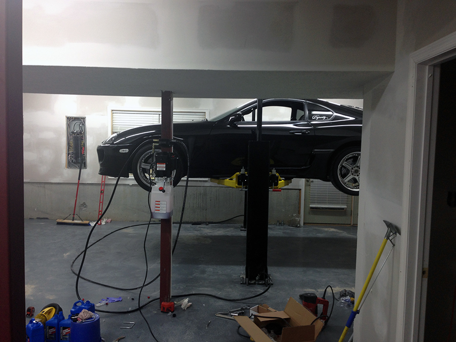

Question about the tile - is it durable enough to support the weight of a car on the lift?

Garage looks great--very nice space. It looks like the one of the posts of the lift is under the soffit. What is the height under the soffit?
Thanks!
Madhatter10-6
Feb 27, 2013
305
Lexington, KY
I wondered when you would post your garage here. Looking great, following with interest! How is Justin's 2JZ32 vert running?
Thanks!
The 2JZ32 is running great! (other than blowing a front main seal). Its more car than we have skill to drive ;) We just got some new tires for it and will be installing traction control over the winter. Ill get some vids up soon.
This tile is incredibly durable stuff. I called LEA and spoke with their tech about its use and what it would hold up to. Summary is if its properly attached to the concrete there isn't anything during normal use that will hurt it. Obviously if I drop a transmission on it from 8ft up it will crack but other than something that drastic it should be fine. It was originally designed to be used inside of a mall and they accidentally ordered 24x24 instead of 24x18. So I was able to pick it up for a great price...as I would never typically choose to afford $8+ per sqft industrial tile. The only downside was that I had to buy more than I needed....which isn't a big deal because I will just sell whatever is left.
I spoke with Maxjax about the lift and a local guru both agreed that it was better practice to install it directly to the floor and then tile around it. So thats where I installed it.
Madhatter10-6
Feb 27, 2013
305
Lexington, KY
Thanks!
Thanks man. I think that was one of the mock up pics. Where we ended up mounting allows for full extension of the lift. When its maxed out the Supra was 12-14 inches from the ceiling.
