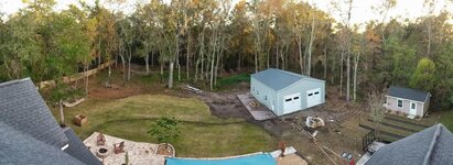

Anyway, Here is my build over the past 3 years
Before:
After: (with about 100 trees gone and over 45 truck loads of dirt)UgZWGoW.jpg
Had to buy some equipment of course!
We originally had plans made for a 30x40 building with 2x6 construction and a loft. I was going to build it my self, planning to do it over 2 years. I was worried about how much time that was going to take away from the family, so at almost literally the last minuted we scrapped the plan and chose a metal building. The Goal was a shop that matched the house, this company has a siding that looked like hardi and the price was great.
The recommended slab was a 4" 3000psi with only fibers. Thats apparently so common here all the concrete contractors i talked to were shocked with i chose a 6" slab, 3500psi with fibers and the thick wire mesh, I think HD only sold the 3x5 sheets of 10g stuff but i found some 8x20' 6 ga. 6mo later and no cracks.
I dug out an extra 5x15ft area 2.5" deeper for the lift area. (total 8")
Pour:
I then put a sprinkler on it for 3 full weeks.
shortly after my shop arrived on a truck
And we have a shell!
Kids love it, i think they think its theirs lol
I bought some insulated hurricane doors off the internet.
Install:
I plan on building a 40x10' porch of the left side, need to start with a another 6 yrds of concrete. Ive actually never done concrete before, much less stamping, but i did stay at a Holiday inn. I had a friend interesting in learning to, (his shops next):
Quite possible the most exhausted and dirty ive ever been:
Done
rinsed:
Need some power:
Expensive month. in addition to the power, i ordered 3000 sqft of insulation for the shop, its foil on one side and white on the other for a radiant barrier, and r11 walls r19 ceiling.
Also bought a bendpak XPR-10aLP (low profile)
Whats next:
-Lights, lots of lights, i have 8 warehouse type hanging light right now and i will be adding 12 48" double fluorescence.
-epoxy Im pretty set on a white or grey norlak system although their metalics sytem looks pretty cool
-Drive way
-install the insulation
-run airlines
-install compressor
-wood porch
-paint my house to match
-install my A/C

I had 2 contractors come out and quote be $110k-140k to build my traditional stick and frame shop... I calculated the of all the materials at only $19,000. So thats when i decided to go at it on my own. I happen to have another dozen projects going on and i knew if i built the shop i would be missing my kids.
The cost of the building shell with windows was approx $12,500 and was installed in 2 days, looks like wood, good for 165mph winds. no brainer

1.Yes, 12ft walls and about 16-17 in the middle
2. I dont think so. I also believe the defualt width is like 5 or 6ft on center for the trusses. I chose 4ft on center so i had the option of hanging 4x8 sheets of whatever. The dealer offered 1" thick foam sheets under the roof, but i knew i was going to put some thicker stuff up.
3. all the doors and windows etc were all cut on site
4. Prob bally not. A porch or sidewalk or even driveway seems a lot easier than a slab. For example, i dont really care about a slight unevenness or bump on my porch, but i would care on the slab.
5. I may have said in the first post, i believe it was about $5500 for the slab, $13k for the windows and shop. everything else was on my own later

The insulation is working very well and making the shop very useful.
1200sqft shop, dark roof, in the sun, in Florida.
Before insulation it would get unbearably hot, both a.c. would barely cool it.
After insulation, it never seems to get over 85-90 with no a.c., and one unit and cool it down to 75 in about 30 min.
One time I turned both on high and forget about them until evening at it was 57 degrees in there in the summer!
I am using 2 12000btu window units
I had some previous concerns over strength of this stile metal building but it experience 80-100 mph winds for a few hours during the last hurricane and took it like a champ. no issues what-so-ever with any of my structures, lost 10 large trees however.

It's the "WMP-VRR" vinyl faced fiberglass insulation. 3"on the walls, 6" on the ceilings.
The cost was about $1600 shipped
I have had no issues with moisture. There is a 4"-20"gap on the roof
