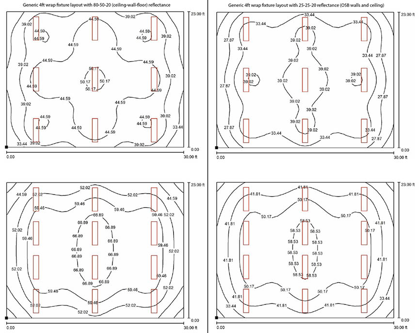

It has been two years since we moved into a foreclosed house with a detached 23 X 30 and 9' ceiling garage, and now it is time to fix up my hideout.
The garage has never been finished (blank slate). When I moved in there was one outlet and no light. I'm still using the one outlet but HAD to install a light. The electrical panel is 200amp and located in the garage, which is NICE.
The walls and ceiling will be finished with OSB with a rusted tin wainscoting and cedar moulding. I like the rustic look.
My thoughts....
1 - 20 amp circuit for lights and ceiling fans
2 - 20 amp circuits for outlets (10 per circuit at 16" and 50") and garage door openers Liftmaster 8500
2 - 30 amp circuits
1 - 50 amp circuit outside for RV
As for lights I'm thinking 6...http://www.homedepot.com/p/Lithonia...-Light-C-2-32-120-GESB/100543144?N=5yc1vZc9h7
Or should I use the lights with the reflectors? I'm also going to connect them to turn on with the liftmaster switch. Which way should I mount them, BLUE or GREEN??
I used the visual 3D design http://www.visual-3d.com/tools/interior/default.aspx?id=14782
WIFI...http://www.amazon.com/gp/product/B005H4CDF4/?tag=atomicindus08-20 Connect to my router.
Here is a simple diagram....had to borrow my kids colored pencils!
What am I forgetting?!
Any suggestions be greatly appreciated..Thanks Garage Journal!!

I have more questions than answers.
50 amp for welder
30 amp for air compressor
30 amp for plasma
30 amp for dust collection.
50 amp for stove to do your own powder coating
20 amp for fridge for beer or??
Just run the wire for extra's before you sheet the walls.
You didn't mention what type of work you plan on doing so I covered a few extra bases for you.
Have fun with you new hideout.

Garage is going to be used for parking vehicles at night, basic vehicle maintenance and odd and end projects. I will have a long workbench with cabinets on the right wall (looking at diagram).
After reading generator thread, might go ahead and connect an interlock.
I'm not installing insulation so adding outlets and running wire in the future will be easy.

Hi Captain,
I would add just a few things,
Place an outlet between the bays on the ceiling. That way at some point you could get a retractable cord reel down the road for easy access to power between the cars. As for the lights, I would switch to 8ft long, Super T-8, 4 lamp, duel ballast fixtures. You could do bi level lighting (2 switches control 1/2 of all lights) it will save you $$ when lower light level will do yet still give you the option of more when needed at a flick of a switch! As for the reflectors a MUST. 2/3 +/- more light output from each fixture then units without them. I install them in all the schools. I'm not sure if you have glass in your garage doors. If you do, place the lights above the doors (when open) so you still get some light from the fixtures when doors are open. (run lights in line with garage door windows) I would also locate your workbench area. Place a row of lights above that 30" out from the wall. When you get old and your assembling your kids projects for school at 11:30pm your not working in your shadow. LOL. I installed an occupancy control for the lights in my shop (40x50). My kids never remember to turn off the lights. It will also kick them on (or 1/2 bi level) when you drive in and auto off when no activity is in the shop.
All just food for thought!
Enjoy your hideout!

I would love to do the setup platonic solid suggested; however, my wife would be SHOCKED if I spent $500 on lighting! I'm thinking either 9 - 4' fixtures or 6 - 8' fixtures with reflectors.
Good call on the garage door glass, but my doors are solid so there will be a bank blocked by the door in the up position.
Since I'm using the Liftmaster switch and decide to use duel ballast fixture I can use the Liftmaster to switch on half the lights with the door and a wall switch to turn on the remaining.
Ummmmm, decisions, decisions

Regardless of what you chose, 9ft ceilings are too low for reflectors. $500 for 15 fixtures is a bargain. A garage isn't much of a workshop without decent lighting IMO.

I decide to go with 12 fixtures, 3 rows of 4 fixtures on 2 circuits. I'm going to alternate lights on 2 circuits, one circuit will be operated by liftmaster switch and will come on when opening the garage and the other circuit with a regular wall switch.
Thanks platonic solid for the light diagram! You have been very helpful

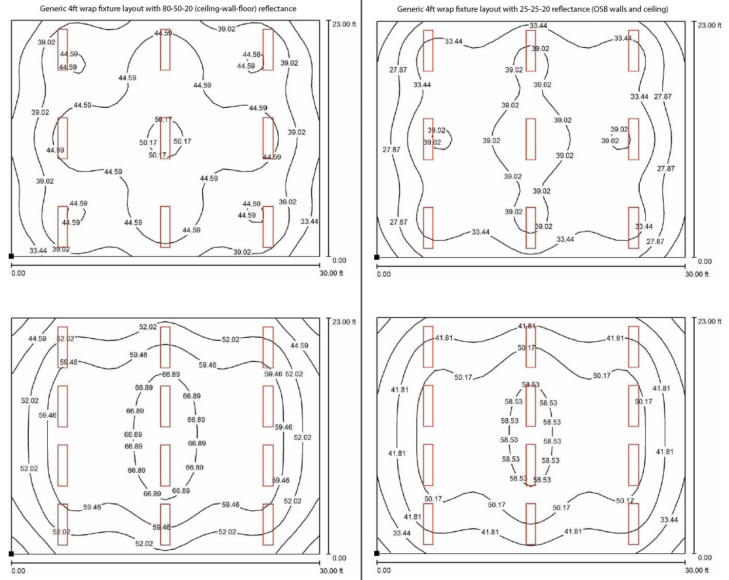

Here's a generic footcandle isoplot comparison of standard reflectance walls-ceilings vs bare OSB:

Change the lumens on your visual3D to 2725 if you use a 3100 lumen lamp. You have an .88 ballast factor you're dealing with.
Consider changing the wall reflectance to a lower level since you're using rusted metal and wood. 25% might be closer.
