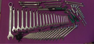

Not all my stahlwille, I am to tired to go and get the rest! I think you get my point why I want stahlwille open ratch 17! ImageUploadedByTapatalk1430854166.475538.jpg
