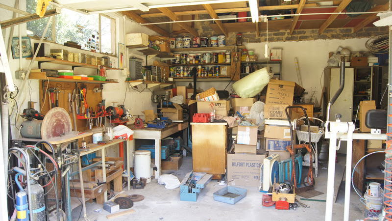

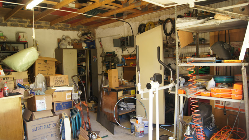

So here I am, a young father of two, now beginning my own journey in the footsteps of my dad. I was raised in the saw dust and earsplitting screams of my fathers woodworking machines, spending every moment I could playing dads little helper. Learning along the way and shaping my own passions for everything tool and material.
The original workshop on my folks property was a double length single garage. I remember how well my father had it layed out with everything flowing into the next step of his workflow - Tables appearing out of walls and machines rotating to accommodate projects way larger than what you think possible in the narrow space filled wall to wall with shelves and boxes of "someday that will be useful" things.
Eventually though it was gutted, made wider, and turned into a flatlet for my Grandparents. Part of the deal though was that he got to build a new workshop at the bottom of the property, as large as money could afford.
Years passed - We never really got the new workshop even close to the same functionality as the old one. My fathers ailing health and old age catching up with him, He spent less and less time in the workshop. As I was young and of the age of freedom my focus also lay elsewhere at that time. Though the workshop never lay idle. Just more and more like a storage room.
It had now become mine though - inherited with all my dads tools and knowledge, and the rest of the families "junk". By the end of Christmas 2008 I opened the door to this...
U53LceWsU2YBvW8I4Mm3GtC0zISe00KmJsW98IADLRc=w800-h450-no
tEcRUkxwlGuVDucGKxCAGbVaTzhiharwcPHDm6_2GAI=w800-h450-no
Now dont be fooled - At this point I had already filled and entire backroom on the property with everything you don't see here - So that I could at least navigate the area. The weekend prior to this I also ended up throwing out a Skip worth of ****.
And so with a little breathing room the mission began.
Everything Inside... Move Outside...

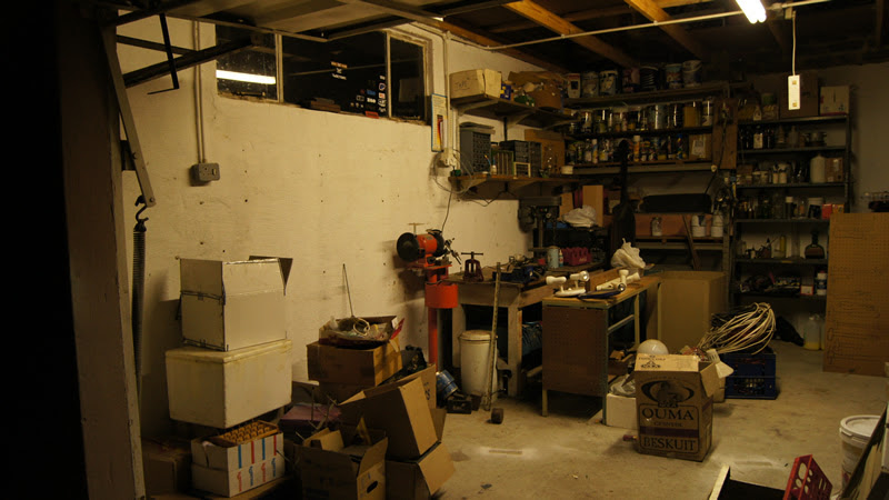

By lunch time I had reclaimed a strange concrete like material I decided to name... The Floor!!!
JzPauFScrdSh0dLezuXFy8TvFrdy3Kn30D2L0e3r6Ic=w800-h450-no
98nWwiJNd2sRfFx2IrtmuDwQw6iS482jFKmHc1ogu-o=w800-h450-no

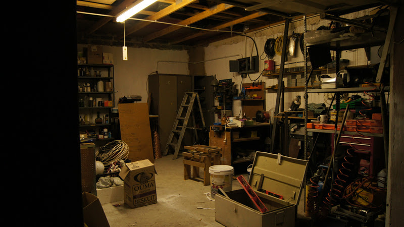

By the days end, and well into the evening, I had left myself with this
EGK76vBRKMEmUEtIYGBy6bomEW6D7COYF02XEar2Of8=w800-h450-no
FHLs3HhexOuZqUp46ZYpMKlf89iPf9ucCESNEtQAgdM=w800-h450-no

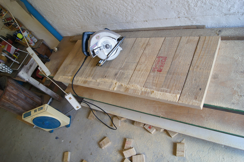

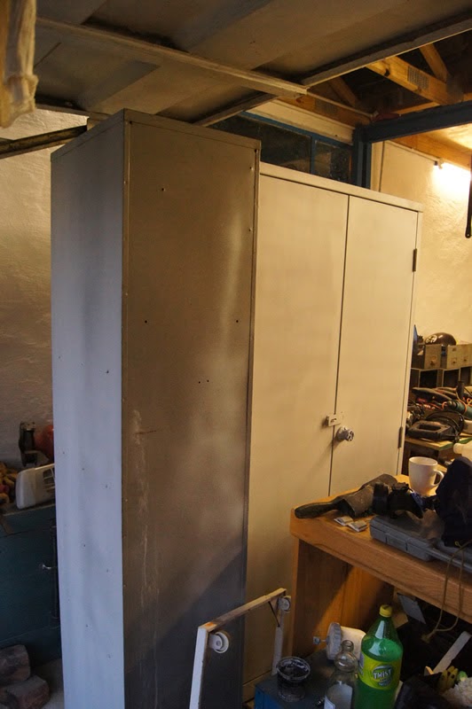

Come the following weekend, I knew there was a lot to do. I had a million holes in all the walls that would need filling - and a terrible leak in the roof where the new workshop structure was adjoined to the old structure of the house.
3tqsS-mHHz8tkUQl-IJpVGp7eyjDAW_NJ2E4zGYrchs=w800-h450-no
Everything had been cobbled together in many regards - Electricity had never been properly installed, the old steel DB board box hanging on the wall is in the same location as it was when this area was still a Shade-net Carport for the folks caravan. The wall with the water marks being the original south wall of the actual house, having never been properly sealed. I decided I would fix the leak - but start from complete scratch with layout and lighting and power.
So with the leak fixed, and the holes filled, I added all the half tins of compatible white paint together, mixed it up, soap washed the walls and threw down a first coat.
Ag8smhRlwUS8RUy_Pj6u4TDJgBzn-qWmmA4QVDNm3NM=w800-h450-no
It already had new life to it after that... in hindsight though I wish I had finished the screeding on the walls all the way up into the rafters instead of attempting to hide the concrete bricks under a weak paint of coat.
1lggnOEr0Rt24QXEzlB5Ly_cLsyBvjVhHSJpbJi_4wo=w800-h450-no

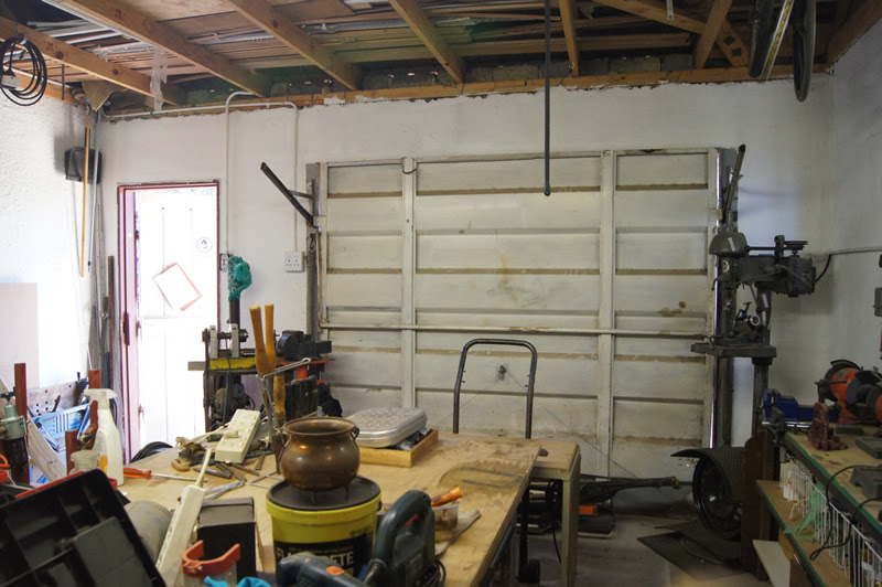

Fast forward a few years and many incarnations (and aggravated roped-in-to-help-with-promise-of-beer friends) this is where I currently sit.
F-Gal1Hkf4th4pCf9e9Io3M9rSDVIFGsboM0NFmkGSI=w800-h532-no
WWHkeabcy-ig2khPbsPsYSHB2_usutjaBokk7xftIkI=w800-h532-no
xq_WF8JbMS_sxyxudlEzJ2ZmOrs8sF46Zzx3KkqwSBM=w800-h532-no

As mentioned above, roughly 2/3 years ago I started remodeling and finishing the workshop. I had used it extensively in the periods between that and the first clean up, but it always felt unfinished, disjointed, and never really worked for me, I began to start collecting materials and working on some of my Ideas.
"In the age of 2013 BGJ (before garage journal) I had at least managed to Get my new lights in, DB Board and Conduit with proper Amp breakers running to dedicated plugs for their intended purposes (welding, Radial/table saw & planer, etc).
I Fabricated & installed an I beam welded up from the old Caravan-port beams (thanks dad for keeping those). It forms a Serif-Font T Shape that is only there to assist spread and support the roof truss spans. Mostly because I was able convert the Space in the trusses upstairs to another small "Loft" type area and wanted the extra peace of mind on load bearing capacity. its mostly light things and small stores supplies and my Peg Board for my future storage of my router guides table saw tools and a few jigs.

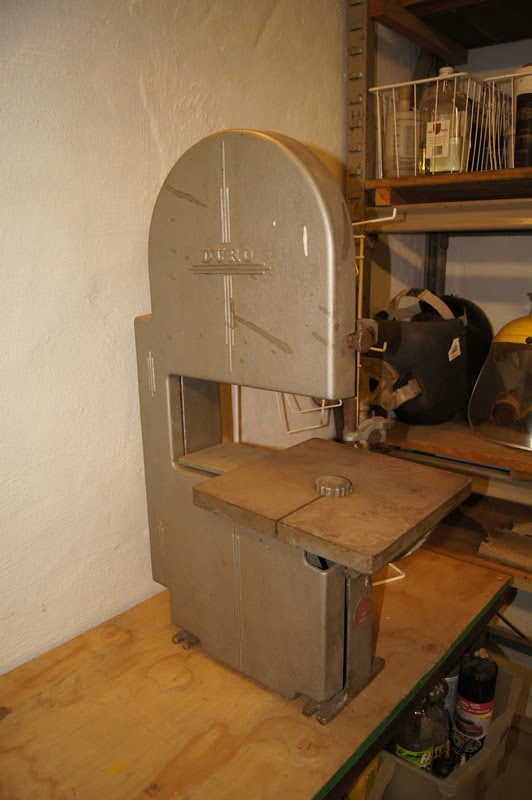

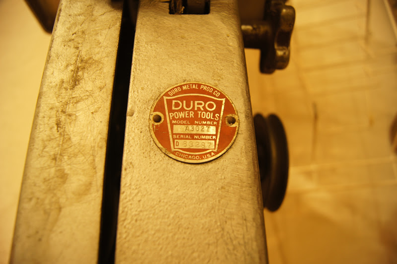

Speaking of tooling... I managed to pick this guy up at a garage sale a little while ago - All for the cost of about 3, 2 litre cokes.
OjNSj9s84ksO2QmMzk8MAELsuD5mfpPQdg8NNe7pcbc=w532-h800-no
Its an old Duro metal bandsaw - My research says quite possibly from world war 2 or shortly there after.
OFuuOgCpCecKxcKAPQ2_doHjoJ8t5WnlDA3cv_3Z5sk=w800-h532-no
In its original condition it comes with a fantastic planetary gearbox on the main drive shaft - Which with the pull of a lever allows you to adjust blade speed for wood or metal. Unfortunately this one does not...
l4qZz_xgG0sXP2z13jmfgILs0lxK2fax2w8enSIHIfA=w800-h532-no
I'm currently hunting for parts - its needs new guides wheel boots a decent clean and motor - I've had no luck in even coming close on finding some sort of replacement gear box to perform the original function - might just have to settle for stepped Pulleys on motor and Main drive shaft. Finding any specific bandsaw parts dealers in South Africa has proven futile. And with our current currency exchange rate anything ordered from overseas is just a joke in price... Right now it makes a great paperweight and being quite possibly the oldest tool in the workshop a great conversation piece among the guys on what projects this machine must have seen over its lifetime and in its heyday

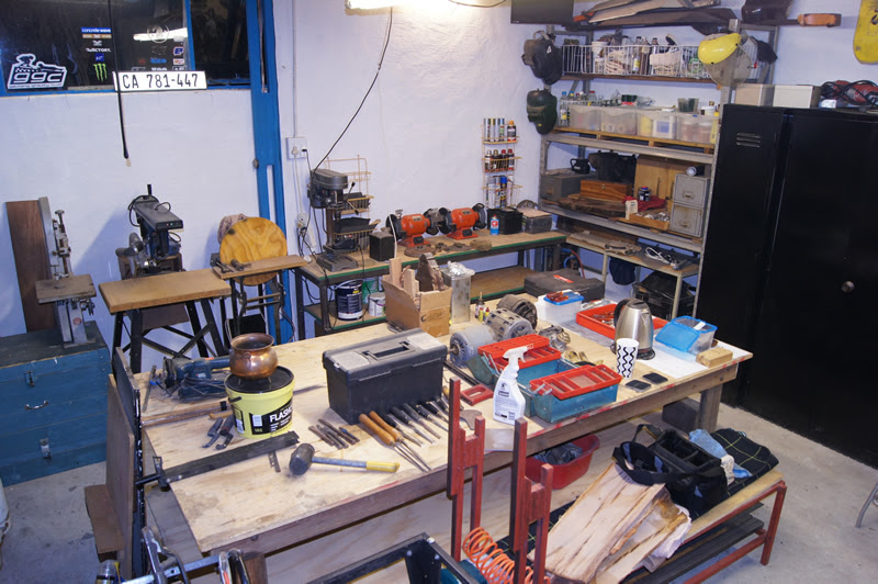

So the weekend last I managed to squeeze out to the folks place a bit - I admit I do miss how much time you have to get things done when you live on the same property as your workshop.
The layout had been bugging me for a little while - things just weren't 'Right'...
So with a little forethought and the assistance of some 3D software(3DSMAX) I modeled out the floor space to how it could better flow. The wood I had been storing at the Main door was becoming a headache and general trash pile. I was always tripping over **** and moving it out of the doorway to work - to move it all back in end of day.
Ci2_Im60xrhM7kUIDxgo8-OcmtTfF45Yf-COBYghb9c=w800-h532-no
The original back corner layout - I shifted the shelves and moved my Jippo bench. With the space left open I organised the wood I wanted, and threw the rest away (all chip board must die! :uzi:)
nb60L-p97Cp3YqXWMVux5M9HgxRCTui2z3rzj1JOiGo=w800-h532-no
QZ1l_9pYJnzurJP6idbSilWxrgBU5yTdxYYrLHWSdhQ=w532-h800-no
Shifted my drill press into the corner where the wood was.
9Fwx3l37zufn7lsza2sjLJBGulpdiaUtSJnLeYz1SY4=w800-h532-no
Its still a mess, I ended up taking two makeshift shelves off my heavy duty set to raise them higher so I could store my radial arm saw and not yet functioning bandsaw underneath them. I havnt yet quite found homes for some of the stuff yet
And the tool wall area had a shift aswell
YIbYQOGMQ0Yui45VJVEUdSiYpyqgxJbgo0caxh3kfrQ=w800-h532-no
Standing in the space, it feels better. The only outstanding mission mongness now is shift the steps to the window wall... it opens up the full wall heading out the small door. And wall space is hanging space for all sorts...

So that leaves my warped and skew long table and a full solid wall to work with.
YCRUoSUfRVgtZAjpap2O6tvnGjdZ9AV8dl0rI2yXzks=w800-h532-no
I'm going to cut it up and re weld one better thought out and just better put together. I'm planning on retro fitting the Radial Arm Saw and my Mitre-saw (when purchased) sharing a common rear guide wall. I can get lengths in and out of the door this side and store them on the lower sections.. At least that's my thinking. It also Gives me the original Double brick South wall of the house over the large single Concrete brick of the window wall... So I'm happier to sink brackets and bolts into it.
What a difference from this... in terms of usable (length) of area...

Decided to test swinging the orientation of my main light
FfPdTDHofMUCsjfnBsiSAWLJp5pVoLdB6Js_j_fPgJU5Z5VQtgo__3auGFuwwV7T_vYbifVEe-RotxRsEp7zZ02pUs6vHv6ncs9B2KFn8YgvrT9T9IzwomGPeOO3DwJbDSTZB1hJdmjHr_gaQEmjl5NjOYLoThXxhr0gCpbScrufHjPD6XVEOUP_xkp86xto8kSnIwPjxYeG4a54LEvQaDpHqrf4-d1wECZbi4M-9ZMpiKykK6lNkWRgUPc2sDbsv5c5cJOWeWGtWl_tWnS2UrU1DDia0IOwgD4-EnQfIDA93Orz_togKFDJ2FGkkIqjJfFUck8DCJsN1kwaLflfoIrb3IgLEqu79WKjI5LZoEqlIOtGTVd5yvKFmf8-JnBIYzJDwCjbsaIWf8MF7uWLuQXV3C0AP4P3rV0yI0dmbL7XK79NOJIT126nWWYyjHoohyjUfI8O8kaJLlFlHBq6lCZig7b3hmQv_pJMvVySSYZbMzCUTaYWatE9gV-K_bMQ__lQgijkrKIvPpOO3ax9tdKCZW-AvCI_OKjmaeF_eoqe21lVFzY3wMzo8S10Z-jeEzVXuL1UFqAlYApLQTN4W5mZx9aKgLUlZ5zLE34ygWJ8Wo5raW1J=w800-h532-no
I'm quite surprised at the amount of extra light it throws. I've now negated the unit above the shelves, and I keep clipping the unit up the stairs - So I see a new lighting arrangement coming soon, I have a particular electrical friend who I'm sure will be thrilled to hear that... again... I wont lie the main florescent light has a background buzz that i slowly getting to me on the days I decide to quietly fiddle in the workshop.

Also been staring at this space of my wall - Its a little over 3m from wall to Blue pole... which is generally the size of stock I buy in material length.
QcVv9Kxv4rXvmHGOlp7GK3kdEu2VVkNkDieSvymclLToIPHw1UrHtel71SU5sAiiSMVa62rMNWT8mthVZMX1kqL1c2hva50Dlxkoi5OlPb-2-2I_TiToYndwxQxH707uRpXDHq_pJ8cxVDbxsEZ21J1Kw98oq3jcMlBIvm0-KUNjbcnHvHUPt0sBzwQUy9Dx-qcOxPNuJECgRSMFeCHU9306l5ZRrX6nG2UWeWX-9MIxacBslpWhliB0u_slUbJ81Kwcw_ZgrSFPnjfy0lLxxlYDcxRB1cbwnAFaWcSEYh8qc-5r6PpndLVn0fAOp70chEkwhrCao0Z6F42kbuYJnhYo1Adm9eBXZbl2Y9NOK7efu6uOlV8SuZ3xvpp6WPY4mZ2iicR-frAo3jakn0DBXRSM2AGVRuMAHyRHLzpJg3qD9Kh0z0fDN0LuRFnemSPtwLc2yZrhsItPzMhUXm9Jcwgz1O7UGYYZE0yvaljgp2jK_Nh0f5yTIDrWc4-eqnTSPa9GaI_U4YzgLKd1FtJ5Jk4SPZ7svLiMhabnp0J5hvjSRF6ZCX_hzpu35ivT2MKeHAcdAv4q5Obg6IpWZryajOQW-KZX3TJYD5Cqo9N76E7EjBx0cRJA=w800-h532-no
I'm liking the idea of a heavy duty on wall rack maybe 3 tiered to store lengths like square tubing, aluminium angle, general lengths of "stuff"
Its where I'm planning on putting the radial arm saw and my Miter saw when purchased on a shared table with common backstop...
nakweaQoR54FJhzo8XJdBZATMWxHYdS5i6r8AduZ7JtEbyI6scFvfIsdWYDpVN-nhKlyjAbsdkEKeJtxcPVWcEZyeLpwVinUymsTCA22lGeAAzux1kRmO4Q6B_0WBTmOhXYzF2wlxQe6jgdMH5GxVrjyNaBsFkGp_r_Wq0UC5KDJ1-_Osd4Itt2USUHaLGIC9Yh6ThNj7LEKp8qL_amCH9VoC2gEtTzdUSEosqwA85Bq9PKswARetjNcLueRH-XeCj7Zp4IkRfCyYccSbywRJW_HNvyRM2baxcz2wxGcjc8VFwKutmssMS8IGHfYI14tdakSqDcU7uBd-d0YZy9O9RS35-rCDgvLdrjId-hQsumnjQKl05yim3GJgqiBuoUf5AlevfkjV_9QsZ0hjIHvzD9OtrLRqmYVZYdIYtbq68GWMNTPC2M1uvNtQaVb_OIyhV0LwEOtZUdBshzkvBccIKlsBWLLqU3jiro337p9XsP_RgnWTVNm_XNh6l4kkNsOJ77ns4ZfhDVJtvstP13xljnLU6h0QO5XYT_KfAFUo7ExPhzkTmSnI_uYBuI_kAfUrp_2O_oMZq5_l6yYDiwSudcDAsqvLVUSJpBQulqlf1UAlgvTDz9C=w800-h532-no
I've already managed to "procure" the MDF board I'll use for the top - Cut length wise it all measure up.
