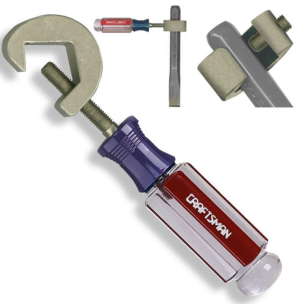

I like punch holders! Here are two below that would do the trick; Craftsman inexpensive and Snap-On high end!
00942839000
Craftsman Punch and Chisel Holder $9.99
Sears item# 00942839000 Mfr. model# 42839
Snapon Stock # PPC5A
Name Punch/Chisel Holder
Price** $33.50
