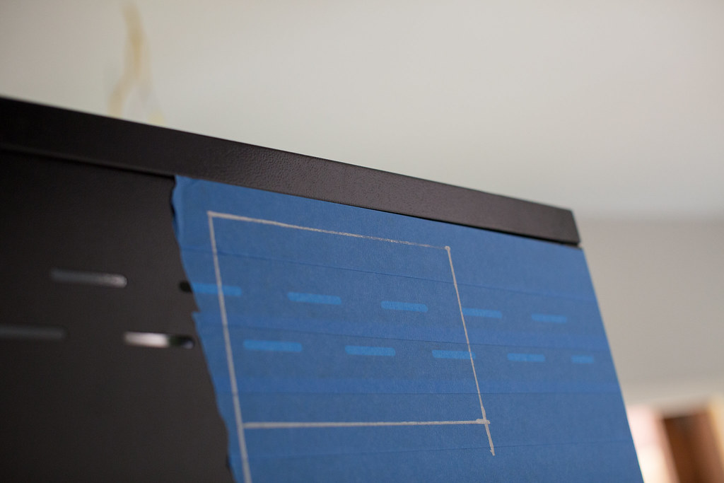

A/V and Lighting Install
The OG Wash Bay Project: E15 - Audio/Video Install
Lights to me are tricky. There just isn't a whole lot of information out there. I haven't found an LED that rivals T8 Verilux bulbs. T5HO are very directional, so I made the decision to stick with what I know.
These are the fixtures I chose for the outdoor washing area after waiting 6 weeks for the AEI version. They are Howard Lighting 6 lamp T8 Vapor Proof fixtures. I ended up having to modify them a little bit to get the mounted to the ceiling.
The OG Wash Bay Project: E16 Outdoor Howard Lighting Install
A forum friend of mine from Rennlist owns a lighting company and sent me some of these for my previous garage to try. They are 6500K and are super color accurate. They make a big difference.
Verilux Bulbs F32T8VLX4 - White - 32 Watt
The Howard Lighting fixtures are taller than the AEI ones that I originally ordered, so I needed to pull the pole down and add another spacer off the ceiling.
The interior fixtures are from AEI. I wouldn't recommend them. The "patented" system to allow access to the guts is junk. The clips don't work very well. I ended up needing to drive some short screws into the sides to get them to seat properly. Anyway...don't buy these. I'm not sure what you should buy instead. My $80 Lithonia lights from Home Depot in my old garage were the same quality as these for $200.
