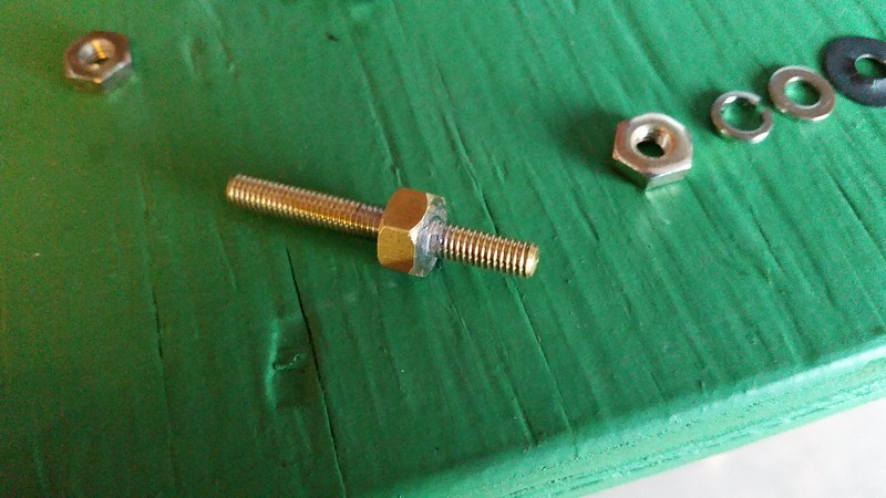

GB: Yes I did have to switch the drive roller around to accomodate 0.6mm wire.
Repair of the welder has been a trying experience. I disassembled the machine and removed the assembly that holds the conductor studs. They are threaded #10-32. I wasn't able to find brass threaded rod or screws in that size, so i had to make my own with a 3/16" rod and a threading die. Already more work than I had wanted to put into this thing, but that was just the beginning.
After making the new stud and soldering the nut onto it, I reinstalled it all in the machine. Being very careful now to tighten everything gently, another one of the studs twisted off. I absolutely was not going through all of that again. The repair this time was to connect the wiring inside the machine completely bypassing this polarity change arrangement. I bought some brass screws and connected everything and found that the welder still wouldn't run properly. Far too many evenings have been spent messing around with this machine. This pin that operates the gas valve in the gun shot out at one point, took me two days to find it on the other side of the shop.
I had the gun apart to check the electrical connection, it had been loose too but fixing it didn't solve the problem. It always ran well with flux core dcen, but that's the only combination that it seems to work with. It's a rebranded version of the same machine in this thread Converted welder to gas--can't get it to weld now! and he was having the identical problem as I am. His solution: buy a Hobart 140.
I'm too stubborn to throw in the towel on this but it really isn't giving me much hope. I'd love to pick up a good name machine that runs on 240v and can justify it for my future plans but I don't have the shop wired yet, and the project sitting in the shop at the moment requires welding.
