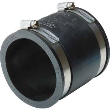

Was out at a job site when I put this together the first time, so I just taped this junction together. The hose and cyclone are the same size (good for maximum particle size) I will find a piece of radiator hose or other to make this connection more permanent, but the tape actually worked pretty well.
I use a Fernco to attach the same size hose to the dust bag outlet on my miter saw.
The stacking solution makes good sense. Surprised none of the players in this market have not sorted a compact cyclone shop vac yet...

I did buy the Fernco plumbing cooler as csp recommended. It worked great (thanks) even when sanding the ceiling with my oscillating sander while standing on a ladder and pulling the whole rig by the hose occasionally.
