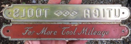

Today, after the requisite RAIN, the air dried a bit, so I took advantage to sand the base coat and tone down the two lighter bits. Then a coat of shellac. Next will be glueing it back together.
Meanwhile, I’ve been picking at the rust on the two tin signs. A few mishaps with the tip of my blade hitting the paint, but overall, success. The couple marks on the back make it clear the orginal color was more vermillion than brick, and has faded. I guess I could repaint it, but that would make the extra care I took scraping the rust off the letters a waste of time. But now those letters have every chance of rusting again. Thinking of clear-coating the signs as they are now. Worste case would be the red paint blisters. Best case, the bare steel stays bright for a long time.
