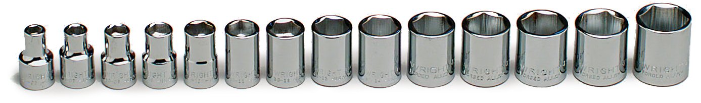

Non-professional USA Made 3/8" 12-15 piece Socket Sets and Prices (circa 11/2016):
Martin Tools MBK14 14pc 3/8 inch 6pt Standard Socket Set - Metric - Approx $58
Armstrong 44-345 - 12 pc 3/8 inch drive 6 Point Metric Socket Set - Approx $58
Wright Tool 354 - 3/8 inch dr 6 pt 14 pc Standard Metric Socket Set - Approx $74
SK SKT13 13 pc. 3/8” Dr. 6-Point Standard Metric Socket Set - Approx $58
Stanley Proto J52212 12 Piece 6 Point 3/8" Drive Metric Socket Set - Approx $57
Williams MSB-12HRC 3\8in. Drive Shallow Socket Set 6-Pt, 12-Piece (USA Made) - Approx $48

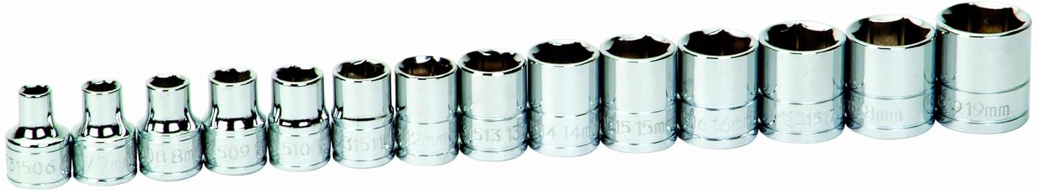

Non-USA sets:
Thanks for the suggestions everyone. I think these are all of them.
Klein Tools 65506, 13-piece Metric socket set, six point - Approx $30
GearWrench 80552 14 Piece 3/8-Inch Drive 6 Point Standard Metric Socket Set - Approx $30
Toptul GAAQ1302 13PCS 3/8" DR. 6PT Socket Rail Set - METRIC - Approx $30
Carlyle Napa CHT SS38012M 12-piece Socket Set Shallow Metric - Approx $30
NWMDC
TEKTON 1815 3/8" Drive Socket Set, 8-19mm, Metric, 12 Sockets
- Approx $22
Williams 31932 [Taiwan] 14-Piece 3/8-Inch Drive Metric Shallow 6 Point Socket Set - Approx $28
Cougar Pro A37, 3/8 Drive 13 Pc. 6 Pt. Std. Metric Socket Set - Approx $27
