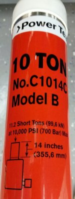

Here is the cylinder for my bender, so I guess its not really pushing 10 tons or anywhere near it when the pump is 4000 psi correct? Yes, the pump is 4000 psi.
Must not need it to bend pipe.

The shaft diameter of the ram is 1.5"
Ayuh,.... To use the hyd. calculators, ya gotta use piston diameter, the cylinder bore,....
Not shaft diameter,...
That cylinder needs 10,000psi to make 10 ton,.....

OK, thanks. Must not need 10 ton to bend pipe as it works well :)
So with a 4" bore and 4K PSI that would put me at 22 tons right? I should be able to figure something out now that I understand the Hydraulics a bit better.
