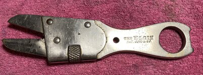

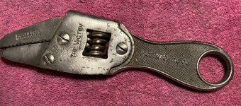

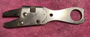

I came across this Elgin Adjustable Alligator Wrench today along with a Kraeuter one as well.

I found this one today and when I did some checking on it I was led to Woody’s great thread. Thanks for starting these threads, Woody!
It cleaned up pretty well considering how old it is. IMG_7091.jpegIMG_7092.jpegIMG_7102.jpegIMG_7103.jpeg
The price on the jaw is pretty amusing.
Nice find. The attachment that goes in the opposite end of the alligator jaw I thought was a genius move. But maybe that was available at a later date as I see the handle doesn’t have the small 3/16- 1/4” hole in it…
31,048
I found this one today...
I suspect it's very early, Don. Between 1897 and 1904 - when they submitted the patent for the insertable die stock attachment.
It's even cooler that you can see the exact same marking rendered on the tool in all the early advertising. Plenty of examples upthread.
The insertable die stock attachment definitely came later. Post #2 shows the progression in patent diagrams. And I remarked on the evolution here...
I don't ever remember seeing an example of an Elgin wrench with the loop handle (first patent). It was probably improved to a solid handle in that same shape before it went into production.
Interesting that they never put the third patent number on the wrench. Woody's example in post #1 is a third patent wrench, as is the eBay example, but they both have the first patent date. I see that the insertable die stock has the second patent number on it.
The patent timeline itself is also interesting. 1897. 1906. 1913. It took several years for he and his partner (Frenk) to realize they could make some use of the round end of the solid round handle for re-threading, and it took several more to improve the guts of the adjustable jaw mechanism.
