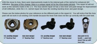

As a total side note: Two of my ratchets are Chinese made C'man and at first glance they look identical to the USA C'man ratchets. But I noticed the head thickness is about 1/32" thicker on the newer Chinese made. Also, the quick release button appears to protrude even more. Other than that I can't see any obvious differences inside or out. In essence the older USA made C'man has a slightly lower profile.
Thanks for the Dykem info. Here's some info on the Chinese/USA craftsman internal differences. It's small, but the Chinese design is supposed to be slightly better. I suspect that the materials are a little worse though, so it's probably a wash.
Thanks that is interesting info. I did not compare the insides side by side so it is good to know that the repair kits are not interchangeable.
So far, I see no problems with my Asian made ratchets other than they could have lubed them better. But I now solved that issue. Thanks again for the good info.
