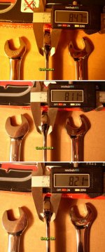

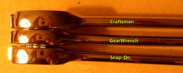

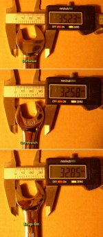

5/8" wrench comparison
Craftsman China 45979 A-AE
GearWrench China 81658
Snap-On USA SOEX20

Just to bring this back up, but I was wondering if anyone else besides me was surprised the Snap-On open ends are actually slightly larger than the GearWrench in both aspects?
One thing I wasn't able to measure, at least not by myself and get a picture of it, was the distance from the tips of the open end to the back of the 'claw' so to speak, which is most pronounced on the Craftsman and largely what gives it that lobster claw look. I'm not sure that actually affects usage though as much as the thickness and outer diameter which I was able to measure up.
