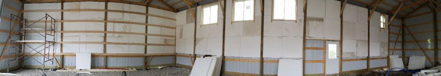

I have been searching via google for some time on this forum and recently joined. My project is a 40 x 64 x 16 pole building. The project started with the frame last July and as of yesterday it received concrete.
Things to do,
Finish insulation, which is 4'x4'x5" foam blocks. That I hope is worth the effort.
I have been watching the high bay LED thread preparing for lighting.
Trying to decide on a floor coating, leaning toward polyurea if I can swing it.
It will have a steel liner for the walls and ceiling.
Heat will be radiant tube heat fueled with propane.
20 x 40 loft.
Plenty of other details to come. Hopefully I can keep on it to keep this thread progressing.

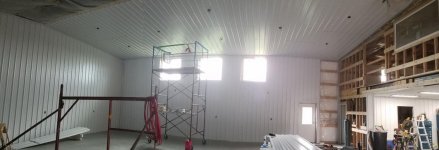

NebrTd
Feb 23, 2017
65
Nebraska
A few pictures of the interior of the shop 90% done. I need to trim around the windows yet.
The red and white "T" shaped tools are what I made to put up the ceiling. They were a lifesaver.
