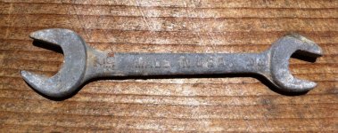

Okay, I know all about cadmium wrenches and how you're not supposed to wire brush them or otherwise make cadmium dust, very VERY bad. So that being said, how do you guys recommend cleaning up cadmium wrenches with lots of dirt and grime, would a light brass or nylon brush be okay under running water? Soak in Simple Green? I've heard people say you could get cancer just looking at these things sideways, not sure how cautious I should be. :)

Avoid creating dust. If you have to brush your piece, do it while submerged in a solvent. I would recommend wearing gloves.
Remember to WASH your hands after general handling!

As a WWII collector, I collect a bunch of cadmium-plated tools. (Most collectors don't realize that cadmium-plating was used regularly on economy line tools well before the war.) I don't get near cad with anything but WD-40 and a fine grade (0000) steel wool. I don't handle it like acid (gloves, mask, goggles, etc), but I definitely wouldn't scrub it with any kind of wire brush. As someone mentioned, it's very soft.

That is correct. Also, it's not nearly as smooth as chrome. It's not dusty or furry like chemical treatments (zinc or phosphorous), but it's not smooth.
I've attached a photo of three sockets with different finishes. From left to right, the sockets are Walden-Worcester polished natural steel finish, Walden-Worcester cadmium-plated finish, and PENENS chrome-plated finish. (Would've been perfect if I had a WW chrome socket, but I don't collect much chrome. :) )

Clean up Cad-plated tools with soapy water. If you are going to scrub with steel wool or scotch-brite pads, do it in the soapy water. When you finish, wash your hands. When you are done washing, wash again. Water can go down the drain, just don't water the tomatoes with it.
For most cleaning, solvent is unnecessary, and likely a bigger hazard than casual contact with the Cadmium. Also wear gloves with solvents, as they will absorb thru your skin, and will carry the Cadmium with it when absorbed.

Don't use Evaporust. It will remove Cad plating. I learned this after soaking tools that were plated.

Cad plating resembles galvanizing, kinda silvery-grey.
Again, DON"T use solvents. Soapy water.
Don't soak them long-term.
Cad plating is not very durable.
OR, soak in the Evapo-rust until all the cad is off, and then wax or oil them and never worry about Cad plating again.
