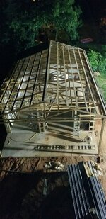

Howdy! After lurking here forever I'm *finally* building the shop I've been pining for. I've mentioned in someone else's "Pole barn Woes" thread some of the difficulty I've met with the City (Longview, TX) but I have gotten past that and proceeded with the project. At first, I hired a "Barn Builder" from a CL ad and it turned out the guy was a thief/scammer. I lost some bucks to the guy but thankfully saw the light before getting MUCH deeper.
EDITING TO ADD: Two Years Later: the dirtbag scammer Marcus Sample Thompson was finally caught, charged and is in the Texas State Prison system for TEN YEARS.
Anyway, after firing him, lawyer fees and the 'down payment' that I'll never recoup, the shop build I had been angling for for years now was on the line. It was already on a shoestring but these losses now meant that I could no longer pay someone to build it. The only way to save the project was to just do it myself....so that's the new plan.
My property is just a residential lot in an older neighborhood. No HOA, just the city to deal with.
Due to lot size and utility easements, I can't build it much bigger or place it differently. I'm building a 30 by 40 by 14H with a 10' gable extension (a porch) on one end. The footprint is 30 x 50.
This is a pole barn (post frame they call 'em now) and the city isn't really well versed on them. All that is settled, though, permit issued, construction is under way.
I will attach some pics as soon as I can.
I'm reminded that working essentially alone results in really slooooow building! It's alright, though. I like to be a bit meticulous, anyway.
I'm *almost* ready to start the metal, hopefully this weekend(!)
The online "visualiser" apps didn't really work for the plan.
Having the pad built... one of the first "sticker shock" moments. I never could've guessed how many dump truck loads would go here!
So I got the big dirt pile done and the rains started. Visqueen to the rescue!
Once the Monsoon took a break, I borrowed a truck to start the project.
Along with my daughter (the best helper, ever) and a couple of others, we set the posts.
I sourced the materials from various vendors.
Lumber: McCoy's (price matched Cassidy)
Posts from Arnold Forest Shreveport
Trusses from Panel Truss Henderson
I hired Arturo's crew to spread the mud
Just a few more boards!!

Did you concrete around the posts? 6x6 posts?
Trusses 4feet on center?
How deep did you set the posts?
How much are you in for materials alone at thus point?
I'm looking to do almost exactly as you but 32x40.
MrSurly
Jan 15, 2014
1,671
East Texas
Good questions;
The trusses are 5' o.c.
Posts (6x6) are 10' o.c.
The holes I drilled to 4' (minimum)
Two bags of Sakrete were used to provide a base and then the holes were backfilled with tamped soil. Later, the concrete slab (4" with rebar) was poured using the skirt board as the form.
Note that the original plan was to backfill with poured concrete as the slab was poured... but due to weather-caused delays of everyone's projects causing a backlog, there was no concrete delivery available at the right time for me. I decided to resort to dirt fill to avoid significant delay of the frame-up.
The overall footprint is 30 x 50, but the enclosed building is actually 30' x 40' 5"
Posts and skirt, all treated ".60/UC4B" _____ 1600
Other lumber__________________________ 1600
Trusses ______________________________ 1600
Concrete (1500 sf poured/finished) ________ 3800
Steel Package (26ga roof) _______________ 5600
The dirt work (pad) was _________________ 4000
The building design is mine, but as the city required "engineer stamped" I had to have a P.E. go over it and amend/modify the plan.
He added more beef and drove the costs up some...but that's OK. The point is only that your material list may be cheaper, using the more 'typical' build specs.

The other big change is that I’ve now added a loft.
The loft is 15x20 and is constructed with 10” S25.4 I-beam and 6x2” steel purlins decked with 3/4” sturdifloor ply.
Due to the garage doors and other considerations I built an I-beam false header just inside the 18’ door, freestanding on two 4-1/2” drill casing (heavy stuff) clearing 8’ to match the door. This header is there solely to support the East end of the loft beam. The other end of the loft beam has a matched casing leg. Each leg has a one-square-foot sized steel foot. These two beams and three legs are freestanding on the concrete slab and together provide the support of the interior side of the loft purlins.
The other side of the loft purlins are welded into a 20’ long channel that is screwed to a 2x8 header that is then screwed to three of the 6x6 timbers of the North gable wall.
So the loft is “freestanding” (bearing on the slab) on the South and supported by the timbers on the North.
Nothing at all connects to or involves the trusses.
Clearance under the loft is just under 8’ and the truss chords above are 5-9 (ouch, ouch again )
When I hung the big beam I recorded the measurement to the floor mid-span so that I can note later if it has deflected and how much as it is used.
