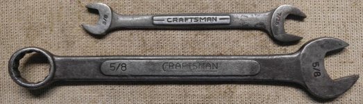

I have some vintage Craftsman combo wrenches. They are in the ==V== style or period. I've read the Craftsman historical articles at alloy-artifacts.org including the Maker-V info. They didn't mention a "O" manufacture mark. Does anyone know a date period for this particular set of wrenches and who would have made them?
Until I took the pics I hadn't noticed how different the marks were from each other on the different size wrenches. Is it the case that even with the smaller wrenches they would/should have the ==V==? If so then I can surmise that this isn't an original set and the original owner likely lost and replaced some wrenches or something along those lines?
I just cleaned up the smaller wrenches this morning by the way. :)
Thanks for any light you can throw in my direction!

I think it was moore drop forge that made those early ones .I believe but could be wrong but that o is just a casting mark of some sort.

A couple of full-view pics...
"...just a casting mark..." Really? Given what I've read and with so many different maker's marks for the Maker-V tools that seems counter-intuitive to me.
Anybody else got Craftsman tools with what appear to be alphabetical or numerical casting marks in the same spot as in these wrenches?
Now I'm even more curious about them. :)

I always thought wrenches bearing the =V= manufacturer's mark were produced by Moore Drop Forge. I never associated a "0" with Moore or any other manufacturer. Although one may not agree, I too would have guessed that the "0" is just a casting mark applied by Moore. It's a nice set of vintage wrenches nonetheless. I do have a Craftsman =V= era 19/32" x 25/32" DBE wrench with a "0" in the same place as found on your wrenches. I also have several =V= era wrenches that bear a definite raised dot in the same location.

From what I understand, the stamped in V is the manufacturers code (who made it), the O that you see cast into the wrench is a manufacturers mark and has nothing to do with identifying who made the wrench.. I don't think anyone knows for sure why it's there. It may denote a date, a production batch, a particular facility, or a manufacturing line. Or it could just be a cruel joke played on collectors like us.
You occasionally see similar letter marks on other manufacturers wrenches such as SK and Williams. A conundrum that the manufacturers never intended for the public to solve, or even ask about.

I always thought wrenches bearing the =V= manufacture's mark were produced by Moore Drop Forge. I never associated a "0" with Moore or any other manufacturer. Although one may not agree, I too would have guessed that the "0" is just a casting mark applied by Moore. It's a nice set of vintage wrenches nonetheless. I do have a Craftsman =V= era 19/32" x 25/32" DBE wrench with a "0" in the same place as found on your wrenches. I also have several =V= era wrenches that bear a definite raised dot in the same location.
Jim C.
As Jake was saying ... we can only speculate on the meaning of the 'O'.
I have Craftsman wrenches with 'AF' and 'N' as well. It could have something to do with the revision of the wrenches, the tooling, the location of where it was made (did Moore Drop Forge have only one production facility or many?), or god-only-knows what other reason.
I have posted pix in the DBE thread showing the 3 different Craftsman -V- shorty DBE wrenches of the same size, all with different dimensions, so we know there were revisions to the tools. We just don't know how (or if) they were tracked. My vote is the 'O' is some sort of revision code. But that's just my opinion.
