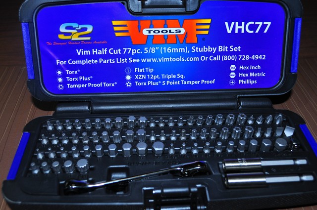

Ford seat bolts. GM seat bolts have external torx plus. I had to chase down a tool truck for both of these. The VIM 77 piece master set covers you nicely for about $165. My set sits idle most of the time but sure is a welcome site when I need it.

Wow, looks like a beautiful set.
