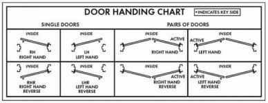

If it is on the egress path the doors must swing in the direction of the egress path, regardless of occupants or use groups. Occupant load and use determines how many exits are needed and their sizes (double or single door). This is from MA commercial experience.
I would change the from exterior to stairwell door to a LH and from stairwell to garage to a RH. Especially if whatever door width you have for stairwell to garage is less than the wall space between the demising wall from the stairwell to the OHD opening.
Handing chart attached to identity all door swings.
