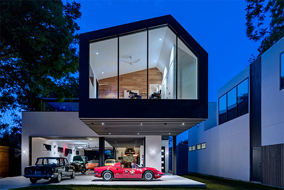

Damn...that's some major cantilever! I'd love to see what kind and size of beams they used.
Okay, after reading the story, I read that they used W30x116 beams. BTW, if you're not familiar with what that means, the beams are Wide flange (W) 30 (30" tall) X 116 (116 lbs. per ft.) steel beams.
'Rule of thumb' for cantilevers in wood framing is 1/3 of beam length allowable for cantilever, so if that holds true in this case, each beam would weigh 6960 lbs!

OK, I'm going to put on my "critic" hat....
The thing just isn't attractive to me! It has some weird angles not related to anything. The cantilever really doesn't serve a purpose? Other than drama, nothing prevent a couple of posts from being placed at the end. It appears to be grass available.
I bet the neighbor next door with those picture windows is real happy!

SO I've looked at this thread for a day or so, as well as the architects other work....
While I like the visual appeal, I was trying to put a finger on what was bugging me.
Many the designs don't seem to acknowledge the function of the building within the environment- they jsut seem like that would be energy disasters. Uncomfortable and/or expensive to heat cool. Yes, I love the glass, the metal...the design aesthic of the roof and the interior ceiling being jsut a 16" structure- no attic, no air. Interiors heated by the sun, HVAC system running all the time to move air around.
Sure the Autohaus house has a slat covered patio by the tree side.... But the rest of that structure just seems to give up a lot of utility for cutting edge design.
Having said that, the same firm MF, has a place called Patterson which utilizes all the features of hot TX design features: low metal roofs, overhangs, shade, etc. To create a liveable and functional space.
Back to Autohaus. All in all, I'm a bit of a mixed fan. Cool, yes. Interesting, yes. Art? Yes. Home for me? Nah.

I hear you, and Ryan addressed this above, but I want to mention that the idea of a glass box like this house is not really "modern" in the sense that the design is current for 2017. The term "modern" in regards to this house is more of a name of a style that was modern in the fifties and sixties but is now kind of a classic style that retains the "modern" name but isn't really modern by the definition of the word.
The idea of the box house is called the "International Style" and originated over the '20's and '30's. Then Ludwig Mies van der Rohe translated this utilitarian commercial design into a house in 1949 in Chicago (the Farnsworth House). Philip Johnson and others ran with van der Rohe's steel and glass house over the decade of the fifties and built minimalist glass boxes to be used as houses. This is why we recognize the design as modern, when in fact, it is not much more modern than Arts and Crafts or Craftsman style. When it was on the cover of avant garde magazines in the fiftes, the style was already thirty years old.
So, this house is really a classic style, and should hold up well over time architecturally-speaking. Now, practically? It will be a hard sell when the current owner decides to move out. The market for this house is probably microscopically small. :lol_hitti

Zoning required site lines (shown as dashed lines on the drawing below) and the need to shed water influenced the form. Not random. :beer:

Did anybody notice that the back part of the upstairs is totally open to the whole downstairs garage? Can you imagine the fumes and smells? This would be headache city. Now granted, I keep my garage clean and pollutant free as much as possible but what about the time you spill antifreeze while draining the radiator or worse, pull off a fuel line (even fully depressured) and sprinkle gasoline around. Straight into the living space even while you're madly wiping it up.
I love the modern design but it's worse than non-functional. Even my relatively new and totally leak free BMW still smells like a car in my garage
Looking at the photos on the designers website, I see there's a glass wall separating the living area from the opening.
