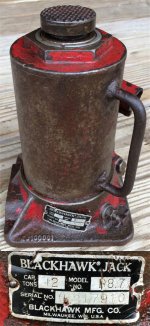

Steve, If you wouldn't have posted pics of your huge Blackhawk bottle jack, I probably wouldn't have had one follow me home today! So, in a way, this purchase is your fault! :lol:
This 12 ton isn't near as large as yours. Seems to work, but I haven't tried it under load yet.
Looks to be from about the same era. The (R) on the label puts this one at 1946 or later. Yours is missing the (R), so it's got to be older.

Thanks for the feedback. User, it's encouraging to enable someone else, yet I've only recently joined GJ :) Your comment about the trademark R is telling, and I appreciate the dates! Lugz, thanks for the link to the ideas book - that's an interesting collection :) Also, it's interesting to me to note in the 1937 ad that EA11s are rated at 20T 48lbs, and FA11s at 30T (65lbs), yet your later document seems to not list the FA11 at all.
There's surprisingly little which I can find on the net about these old jacks. However, I did find a couple eBay auctions for pages out of old (hardware store) catalogs, which have a little info about these jacks. User, these may be informative for you, since your D-8.7 is listed in both. Unfortunately, neither has a date which I saw on the page, but the sellers specified when they were published. The first is allegedly from 1937 and the second is allegedly from 1940.
