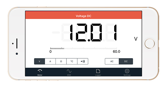

I just bought a Fluke multimeter... When doing so, I was thinking about how ridiculous it is that I had to buy the thing when I have an iPhone in my pocket with the compu...

I have a multimeter that uses a phone/tablet or your computer as the screen / controls. It's a Hantek 365F. I got it because it is also a logger and can take data over long periods for doing device current draw measurements. I think I paid around 70$ for mine which is what that Pokit thing is but this is a lot bigger and more... ruggedized.
Still a neat device though. Too bad they didn't just put 4mm ends on the retractable leads so you could put different tips on it. I recognize they were just going with what most people would use but it seems like the strength is it being wireless so you can attach it to something and leave it. Being able to stick backprobe ends on it and leave it in the engine bay would be pretty handy. That's how my current one can be used.

The Pokit thing does look pretty cool, but seems like it would be pretty useless for anyone other than the hobbyist. Any measurements above 60V won't work with the Pokit. Even the low end Flukes, like the 115, can go up to 10x 60V. I can see how this would be nice to have for the DIYer though, since a lot of those measurements would be low voltage, low current measurements.
When I'm at home, I have no problem pulling out a dedicated DMM, since I use it so infrequently anyway, and it would end up just being more of a pain to take it everywhere, even if it is really small.

I noticed that there was no safety ratings on the Pokit device. That could be because of the low voltage range. If they decided to ramp it up to 120v or higher, then they'll need to completely redesign the thing.

This dude, however, is working on that. I don’t think it’s there yet for a serious maker type, but I like the innovation.
The reason you buy a fluke meter is for the a) accuracy and b) knowing the damn thing won’t blow up in your hand (accidentally ohming a live circuit). For the hobbist it seems cool, but for real work no way. I own a few flukes that will display the live values on an iPhone via Wifi. Nice to watch a circuit from a distance.
I also totally agree. Processing power isn't really what matters for meters.
The Pokit has a basic accuracy of 0.5%, my Fluke 87V is 0.05% and my Fluke 187 is 0.025%. For many applications this is unnecessary, but for some users it is essential. And the protection circuitry on Flukes is widely regarded as best-in-class.
Fluke meters are known for exceeding their stated accuracy and holding their calibration in the long term. They use quality components whose values don't drift. John Fluke's philosophy was to give the customer a bit more than they were expecting.
Finally, the dearer Flukes have a lifetime warranty.
BUT the Pokit is a neat little gadget and I hope it does well.
