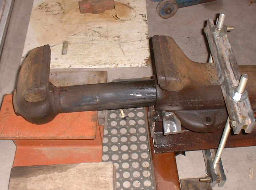

Here are the pics. It is still frozen... I used my Oxy/Acetylene torches. Quenched with PB... Beat the damm thing and it still is stuck.
Every thing that could turn on this Vise is frozen solid. Musta been left out for some time.
I am now soaking it in a 25% solution of Muriatic acid for 24 hours.... Lets see what happens.
Any advise would be helpful

Cheap easy solution! Make a mixture of 50/50 ****** fluid and acetone and let it soak in there for about a day. Then with a couple bottle jacks and some i-beam make a press to that you can apply a constant force and slowly break it free.

From the pics. The vise has alot of soot on it. You are using too much gas and not enough Oxygen. You cant heat properly that way. You need and oxidizing flame to heat it right. From the looks of it. You did not get it set up properly to get the heat too transfer.

I knew someone would say that when I took the picture. I got the flame correct later....

If you have access to an ultra sonic cleaner put the vise in with evapo-rust the action in the machine will force out the oxides and crud. Let it set in the machine about 2 days and then try and free it. If it doesn't free put back in and try 2 days later.

I viewed the cutter thread but never found a solid answer.
Things I thought about (some I did)
Putting it on my 5t jack and putting it under my truck and pump up the jack (too heavy and awkward to stay)
A spreader (between the jaws). Only about 3 inches there, so I don't know how a bottle jack can help.
Beating it mercilessly... Someone already tried that and it was starting to crack.. I added about a 1/4 inch crack trying to knock the Bejeesus out of it.
Picking it up and dropping it.... Tried this several times from ranges of 3-5 feet. Just knocked chunks out of my concrete.
My HF 20T press (too wide to fit).

I think you are rushing it, instead of risking breaking it or you why not let whatever you soak it in do it's job? I can't say I have had to break free a frozen vise but I have had to break free numerous old pieces of equipment, firearm actions from the late 1800s ETC. If they won't come apart easily I soak them in a kero and ****** fluid mixture and forget about them for awhile. Put that thing in a 5 gallon bucket with a mixture of kero and ****** fluid and let it sit at least a week, it will come loose eventually.

From the looks of it, it's rusted at the screw. Did you apply heat right to the screw area?

Part II.
Here it is in the Trash bin after a 24 hour bath with a 25% solution of Muriatic Acid.
Now time for neutralizing it (used another Trash bin)
Fresh out of the neutralizer....
Beating on it doesn't help.... Lets see if I can use my press... Last night I didn't think it would work...... Awesome!!!.... it fits!!! (just barely!)
Getting everything ready. I lost my pins in the move.... These Prybars will have to work...
Putting it in place...
Here Goes!!!
It moved!!!
Great, now I have the jaws shut!!!
What now???? I can't turn it the other way in the Press..... lets put the screw/turning mechanism back on and try to loosen it.
Gotta replace the broken screw that holds the screw mechanism in place.... I have a bolt but it won't turn with the head on it..
I found a bolt with the same thread, put it in my other vise and cut the head off with a hacksaw... Then used the hacksaw to cut a slot for a screwdriver.
Putting it back together.
The jaws open up!, but it takes all my strength to move it.
Brushing off excess rust and soaking it with PB.
As stated earlier, The jaws open up, but I must use a combo wrench as a cheater....
I'm smoked... It is 90 degrees out and I am soaking wet. I got it working... I can take it apart and wire brush off the other stuff later.
Now my final issue is getting the handle to slide, getting the base locking mechanism unfrozen and replacing the locking bar (any Ideas?)
Then perhaps I will restore this thing and show photos like ELROY.
Thanks for the advice....

Remove the screw and get another set of hands to hold the whole assembly while you use your press to push the handle back into usable shape. I did exactly that with an old vise handle on one of mine.
Yeah, I just came up with a plan to get that thing unfrozen.... It should work... I will post pics tomorrow :thumbup: in PART III (Stay tuned!!!)
I need some suggestions on the base swivel lock. I have bent some bars trying to get that thing to turn.
