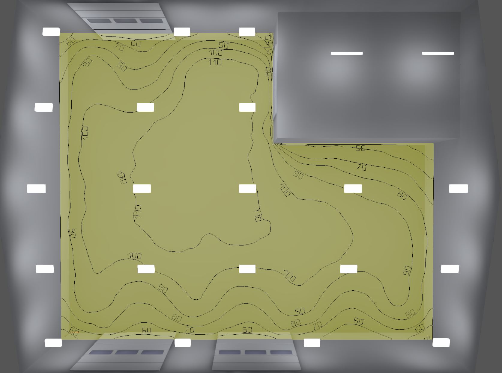

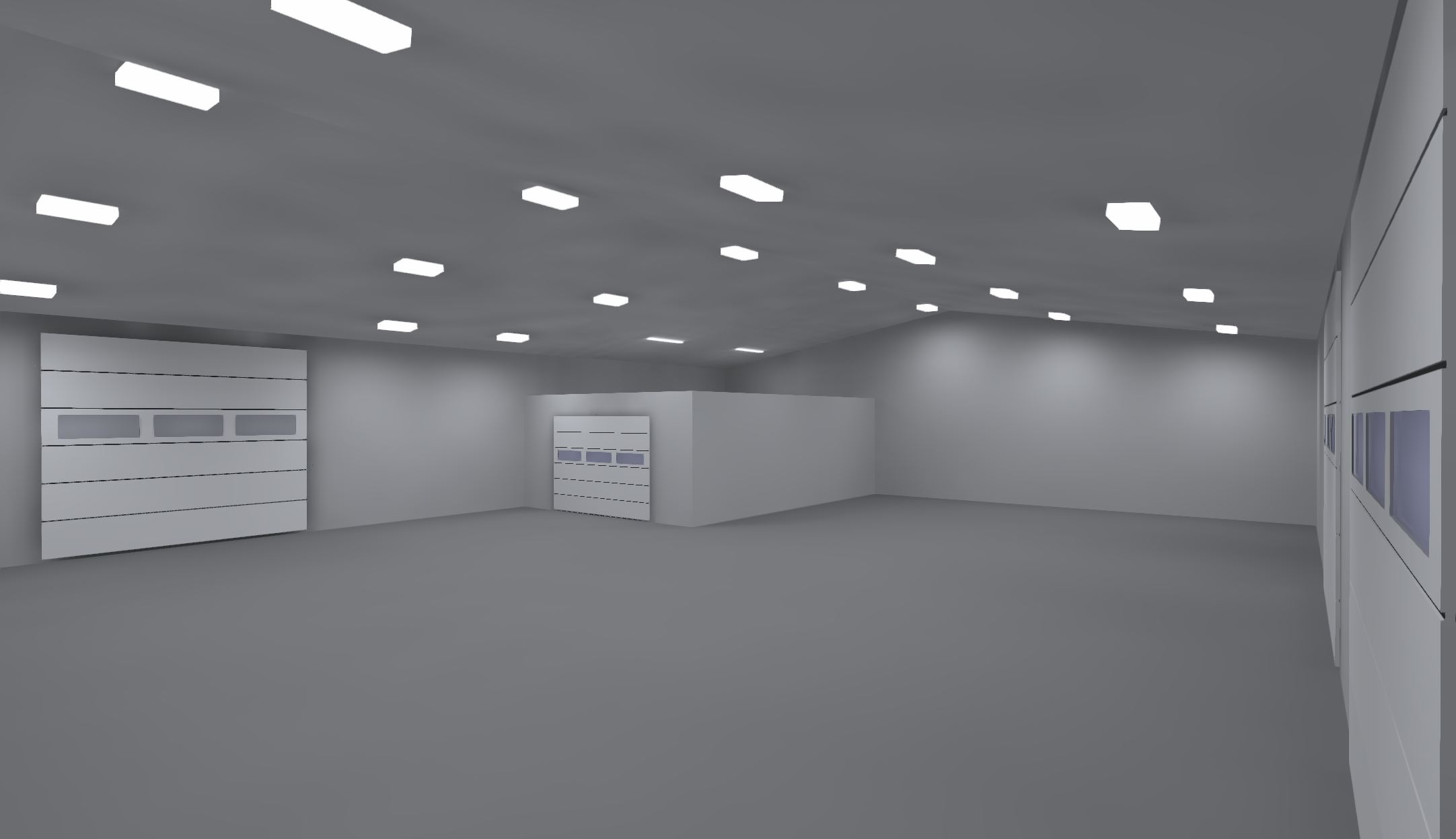

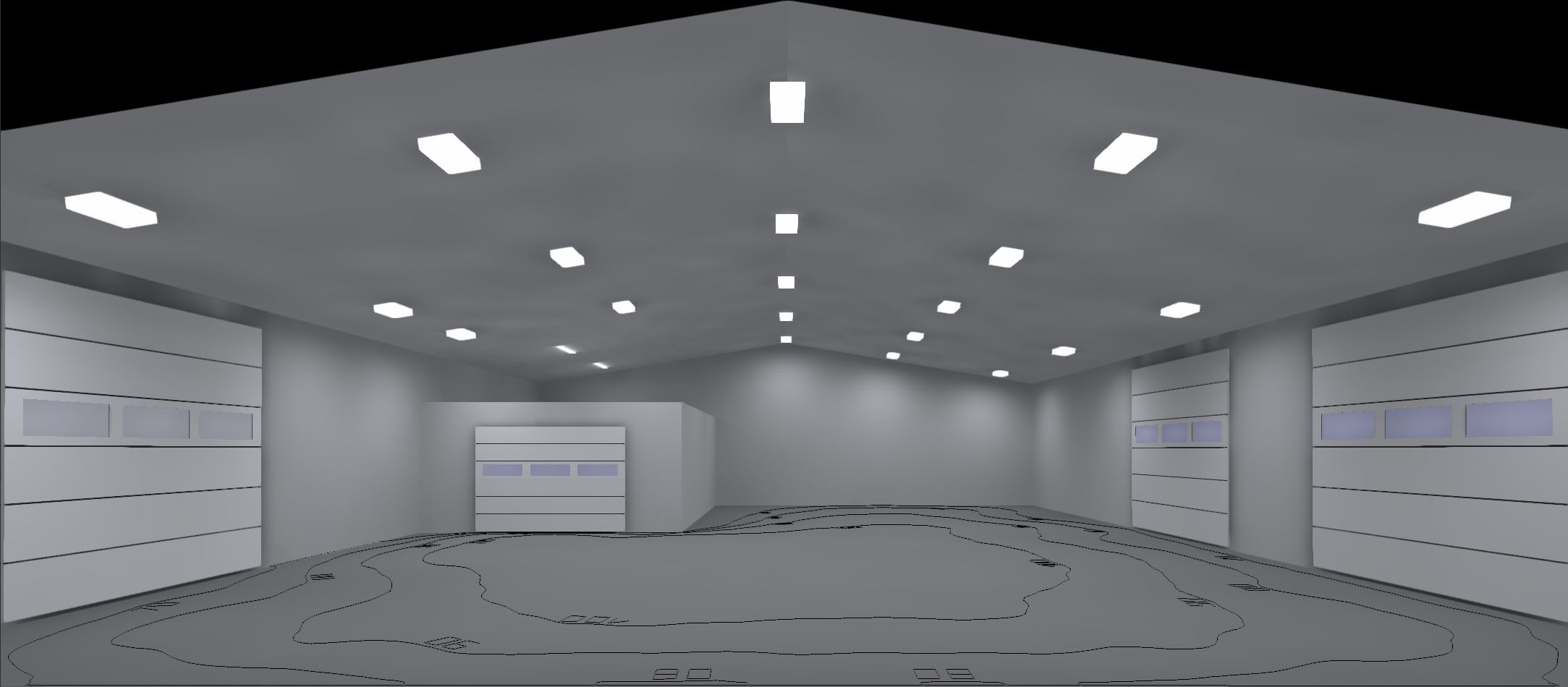

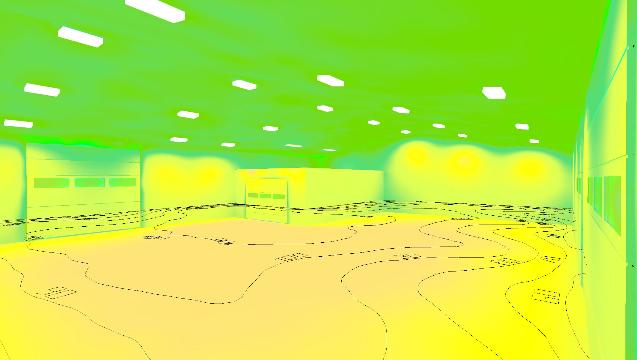

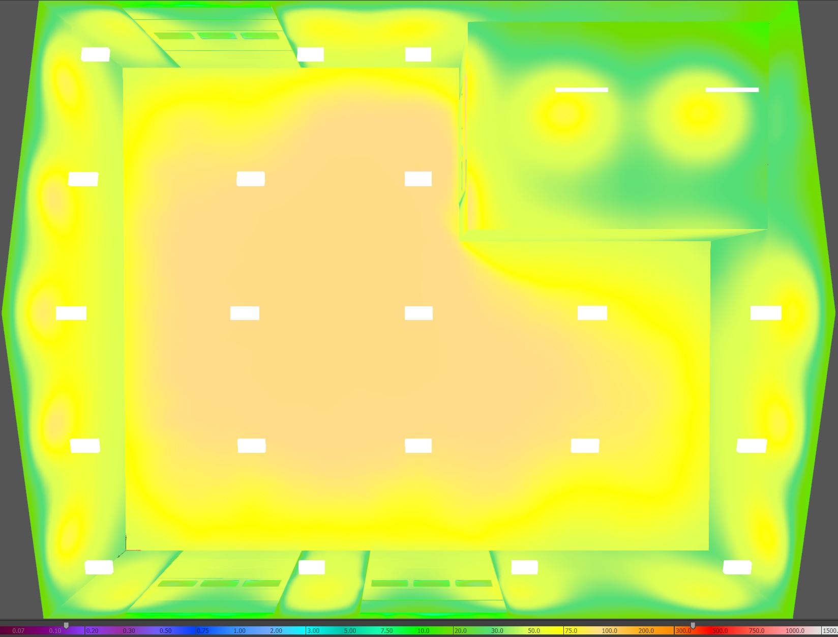

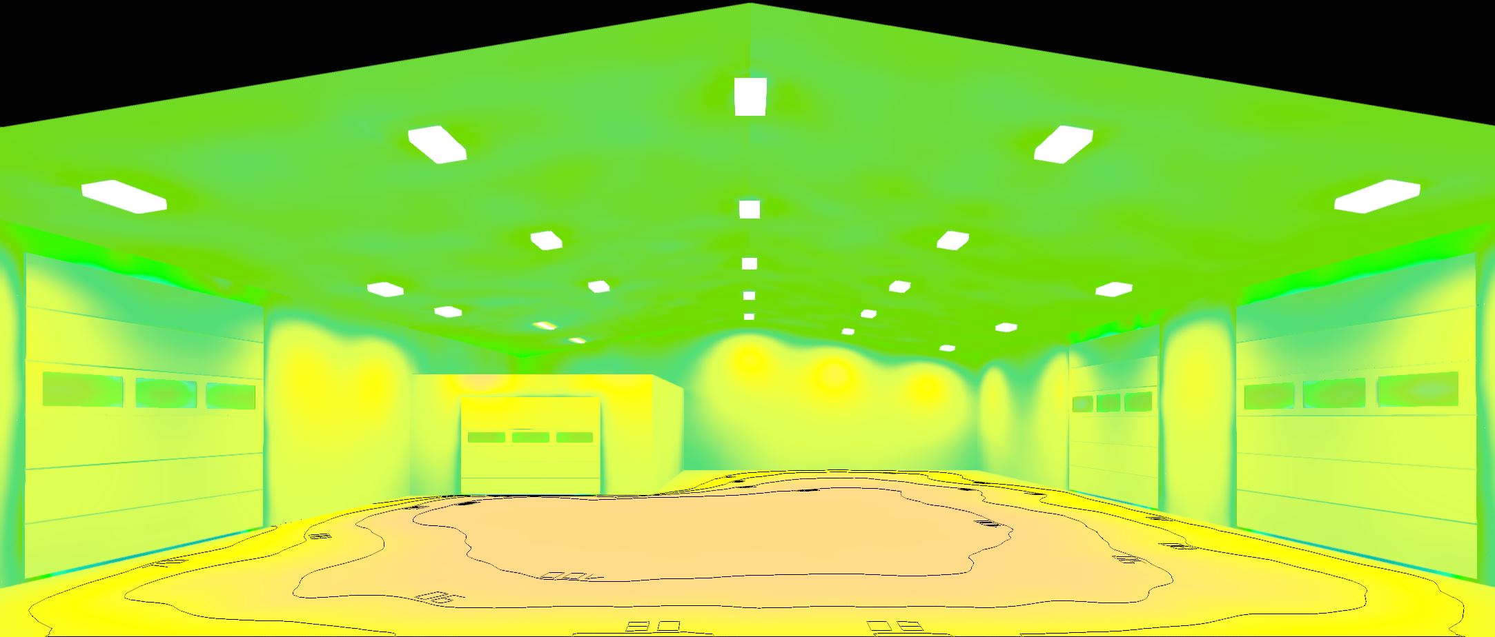

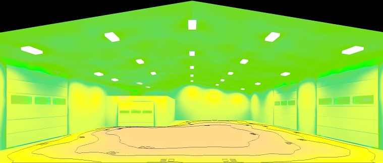

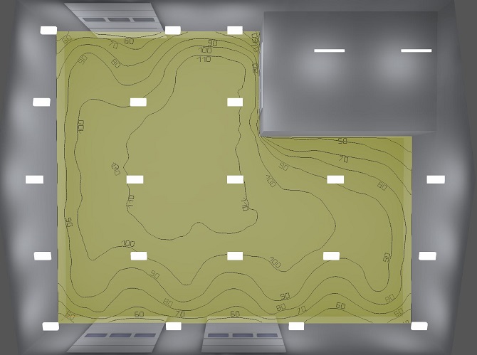

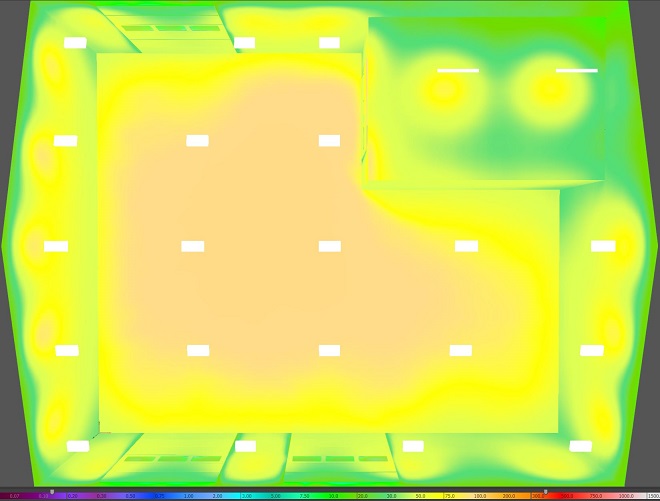

Just thought I’d post an update on my lighting project. I had Platonic Solid work up a lighting layout plan for me and I am very happy with the results. I used 20 110W 1’x2’ LED panel fixtures. I have yet to install the strip lights over the assembly room to illuminate that area, but the work area is going to be great. These pics show up darker than it actually is.

Thanks for posting the "after" photos. That is one evenly lit floor! Is epoxy in the cards? I like how the door track is up and out of the way from day one.

Thanks. I sure would like to do the floor in a light color epoxy, but the cost of doing 3000 sf will probably nix that thought. At the very least, I need to seal it to try and protect against oil spills or whatever else might happen. I’ve read through so many threads on the floor coating issue that I’m exhausted. Lol. Thanks again for the compliments. Ron
