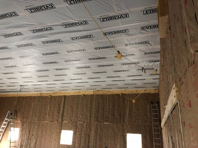

Hello, I am just about to the lighting stage of my pole barn. it is a 40x48x16 barn, I will be using it for an automotive shop. I know these questions have been beaten to death but I would like some recommendations on good brands of lights, spacing and anything else anyone could share, Thank you!!

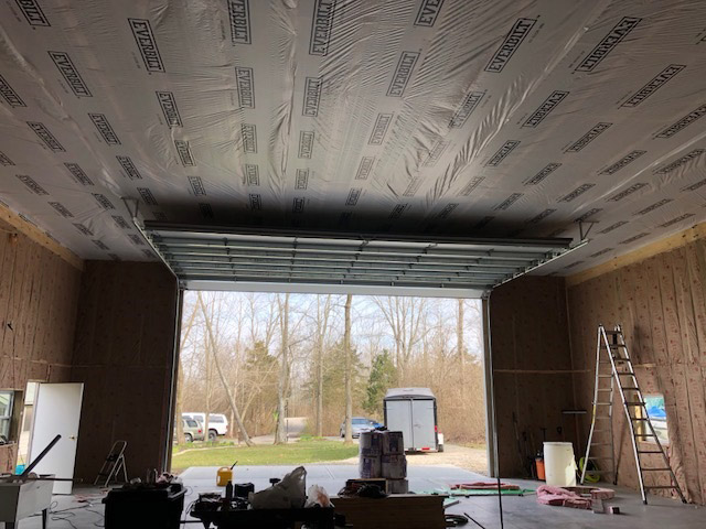

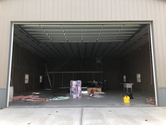

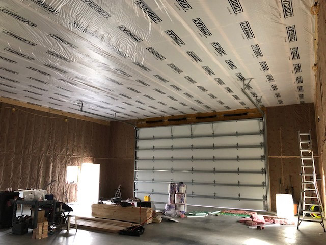

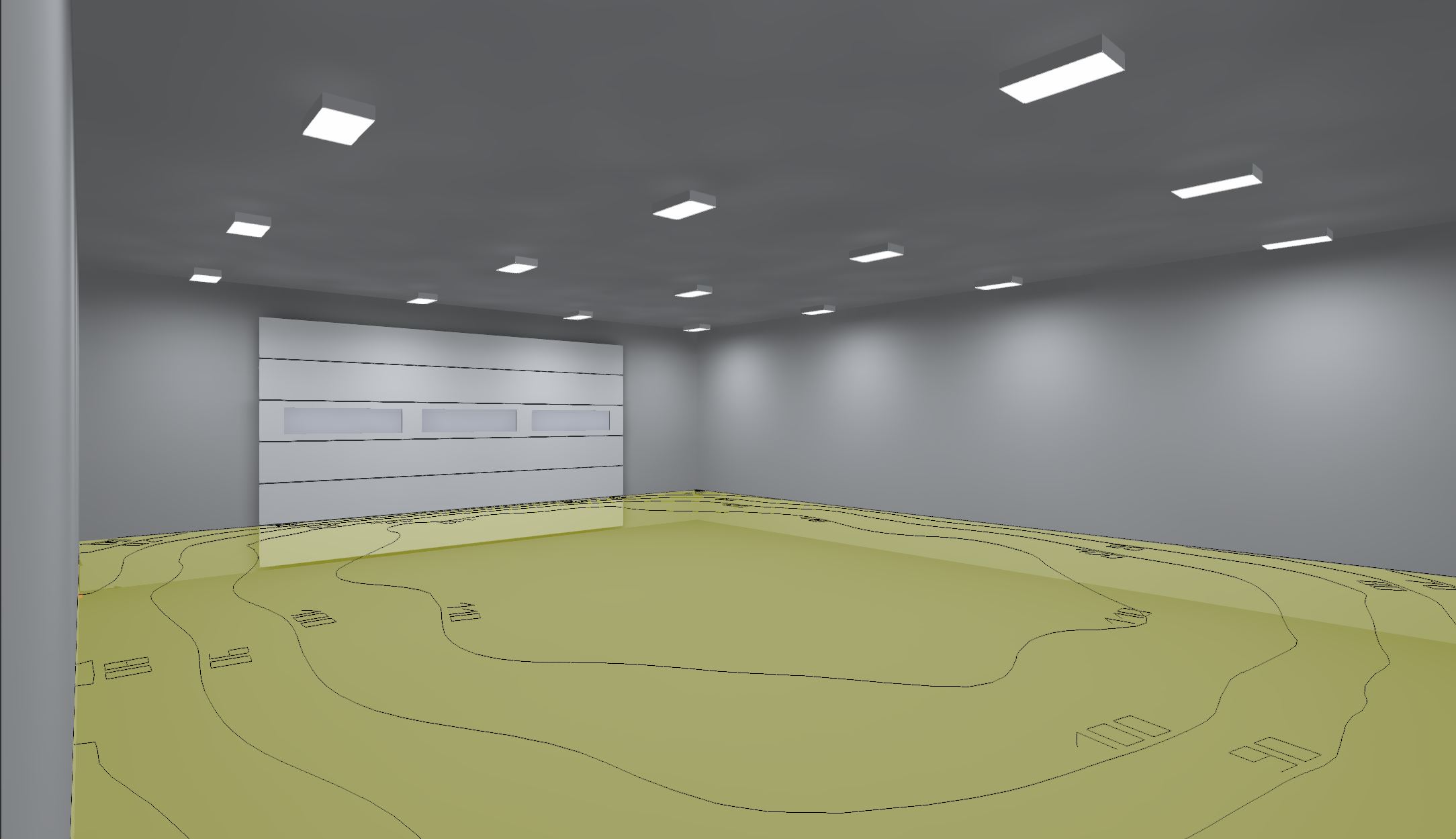

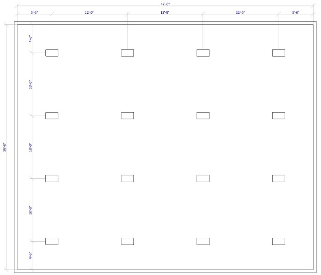

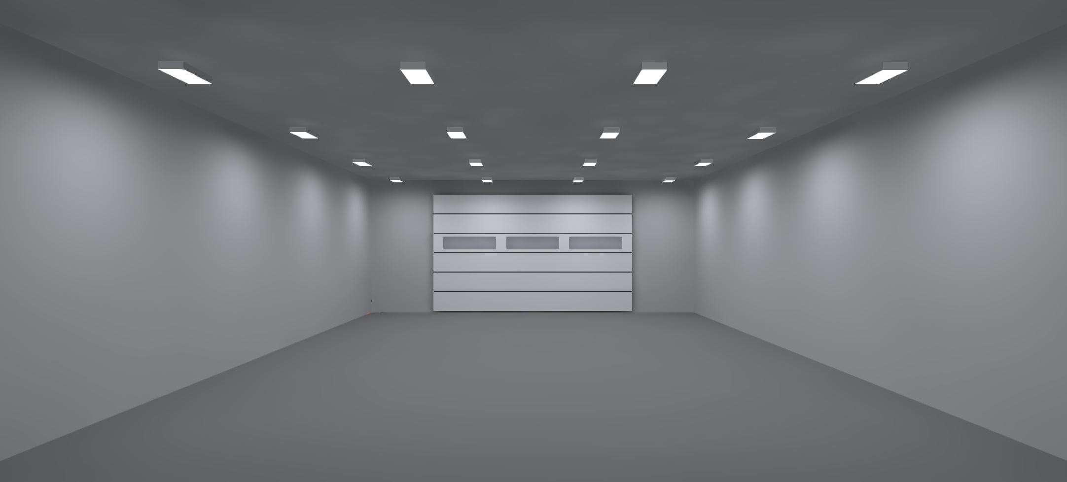

Pics from Kram02’s 40x48x16 build. His massive 24’x14’ garage door dwarfs how big this space really is.
Platonic Solid
Nov 29, 2014
3,587
CT-USA

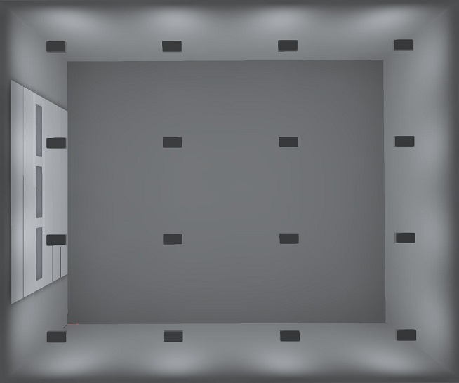

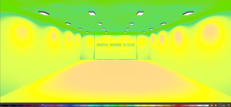

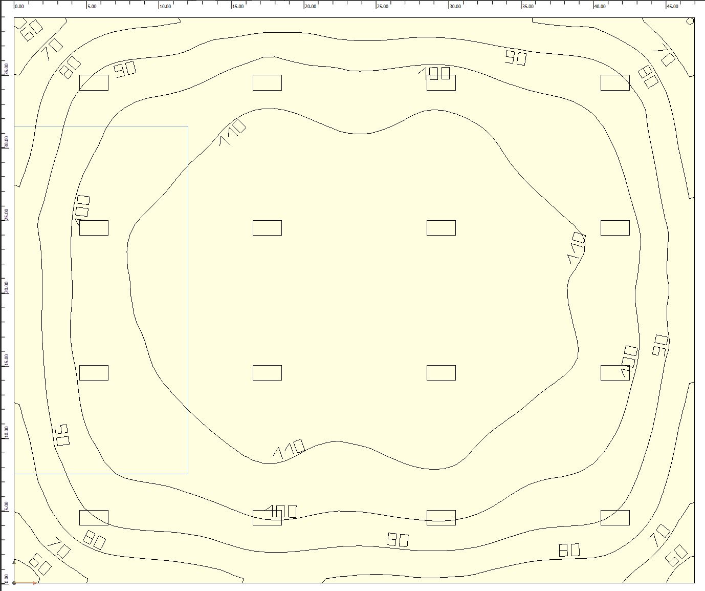

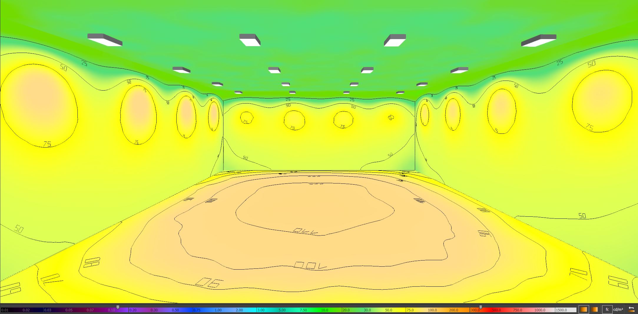

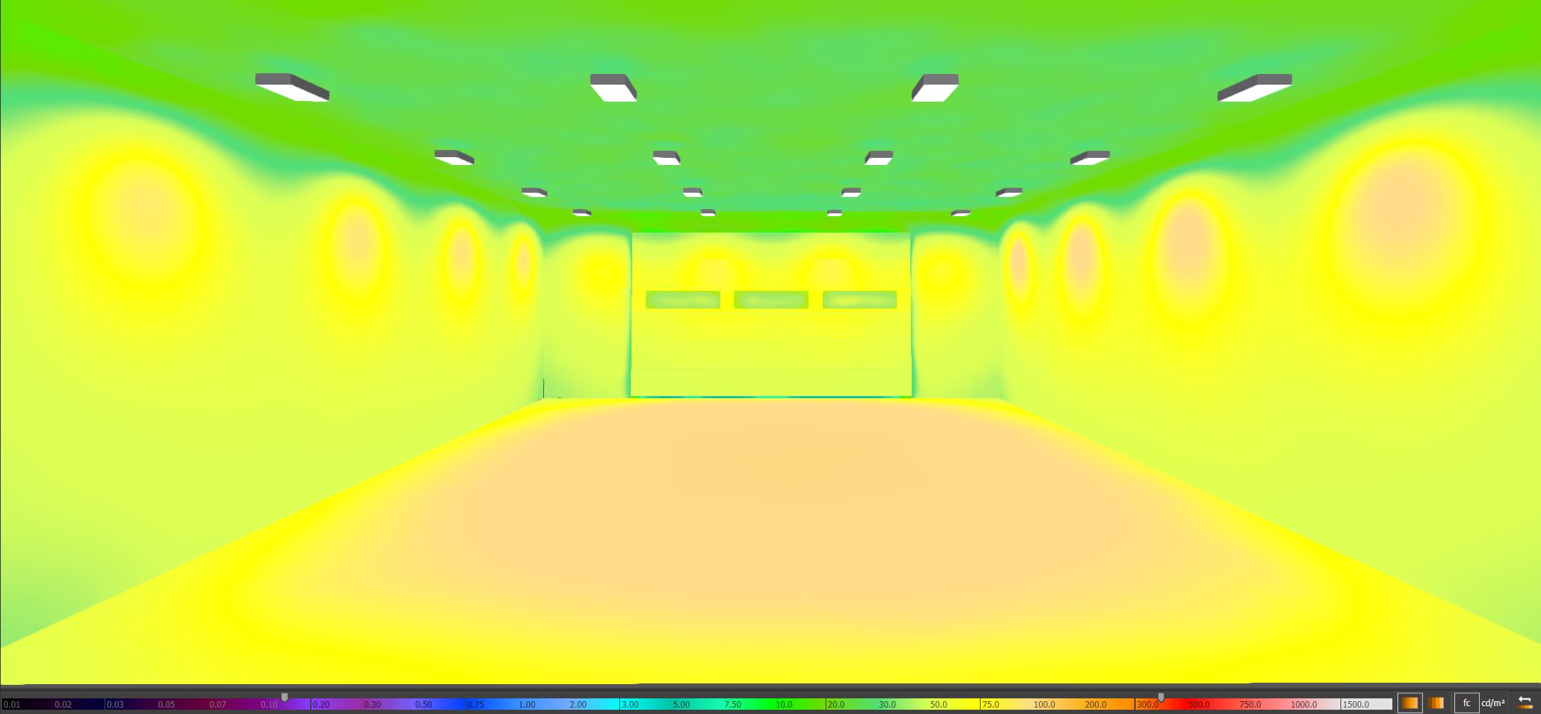

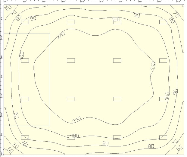

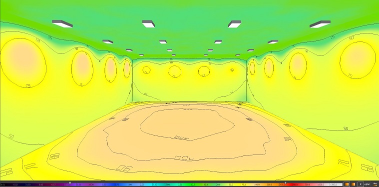

Qty.16 GreenTek GT-H2-110W 16,400 Lumen sold by greenlightdepot for $85 (link) = $1360.
It does not have surface mounting brackets available, but does come with “V” hooks and chains.
GreenTek is a relabeled James ZY-H2-110W fixture also sold by ledlightingwholesaleinc for $95 (link)
Dialux PDF Report (link)
Avg yield @ 30” workplane = 101fc
Total Lumen output: 262,528 lm
Total Wattage: 1760W (14.67 Amps @ 120VAC)
images linked to larger pics
Hi Platonic, it says the greentek does not have surface mounting brackets available but your image shows lights that are surface mounted? Do you have a link to those per chance?
Platonic Solid
Nov 29, 2014
3,587
CT-USA
Actually the image is misleading. The garage ceiling is 16', if you open above linked Dialux report you'll see on page 2 that they're hanging at 15.5'.
If you wanted to convert the GreenTek to surface mount you will need to install rivnuts in the 4 corner housing holes and find suitable brackets - Beeslighting sells brackets, but you'll have to investigate the spec sheets to confirm fit. Please post pics if you do this as I've been waiting for someone to try it. I would expect Diva Lite brackets to fit.

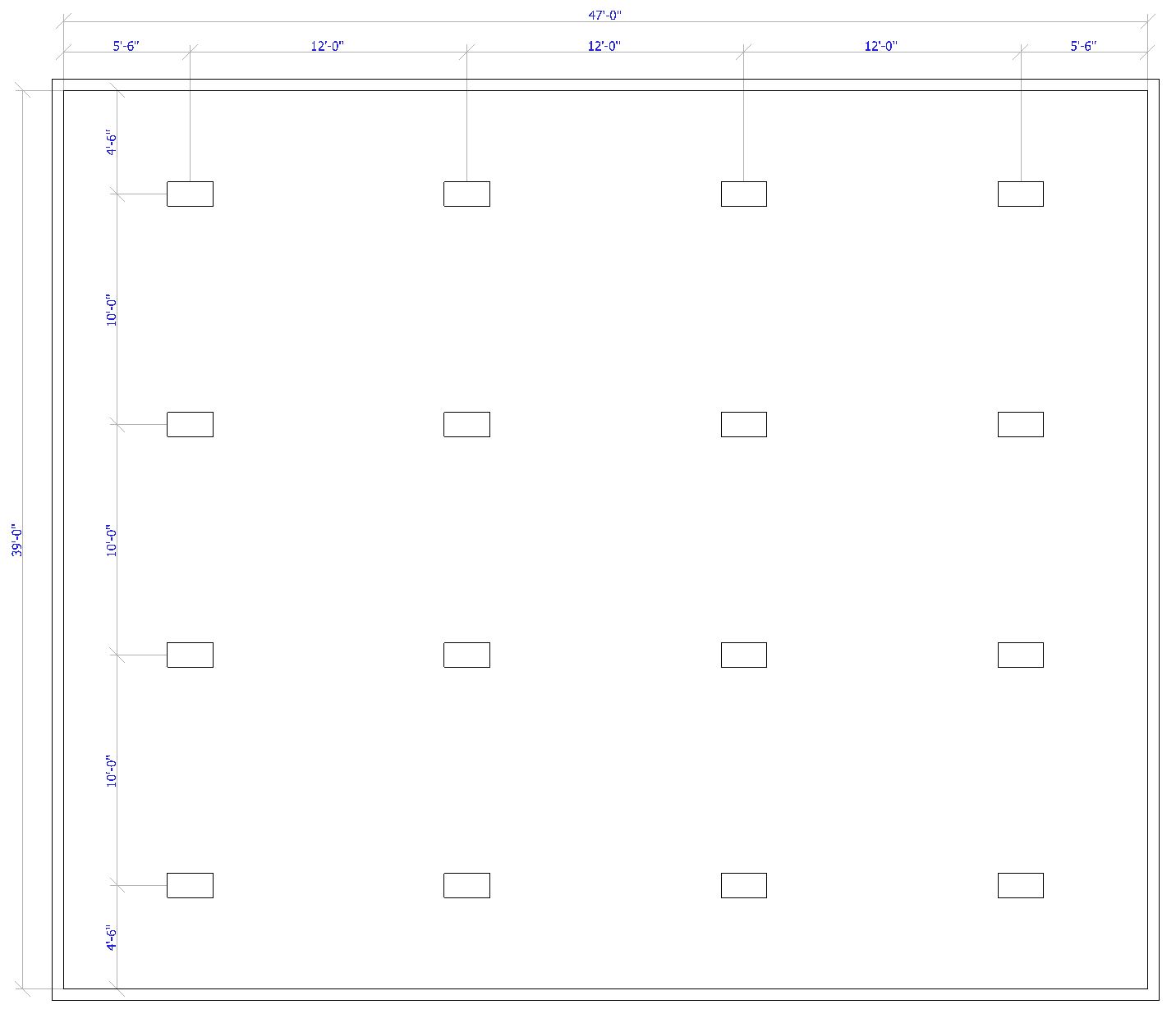

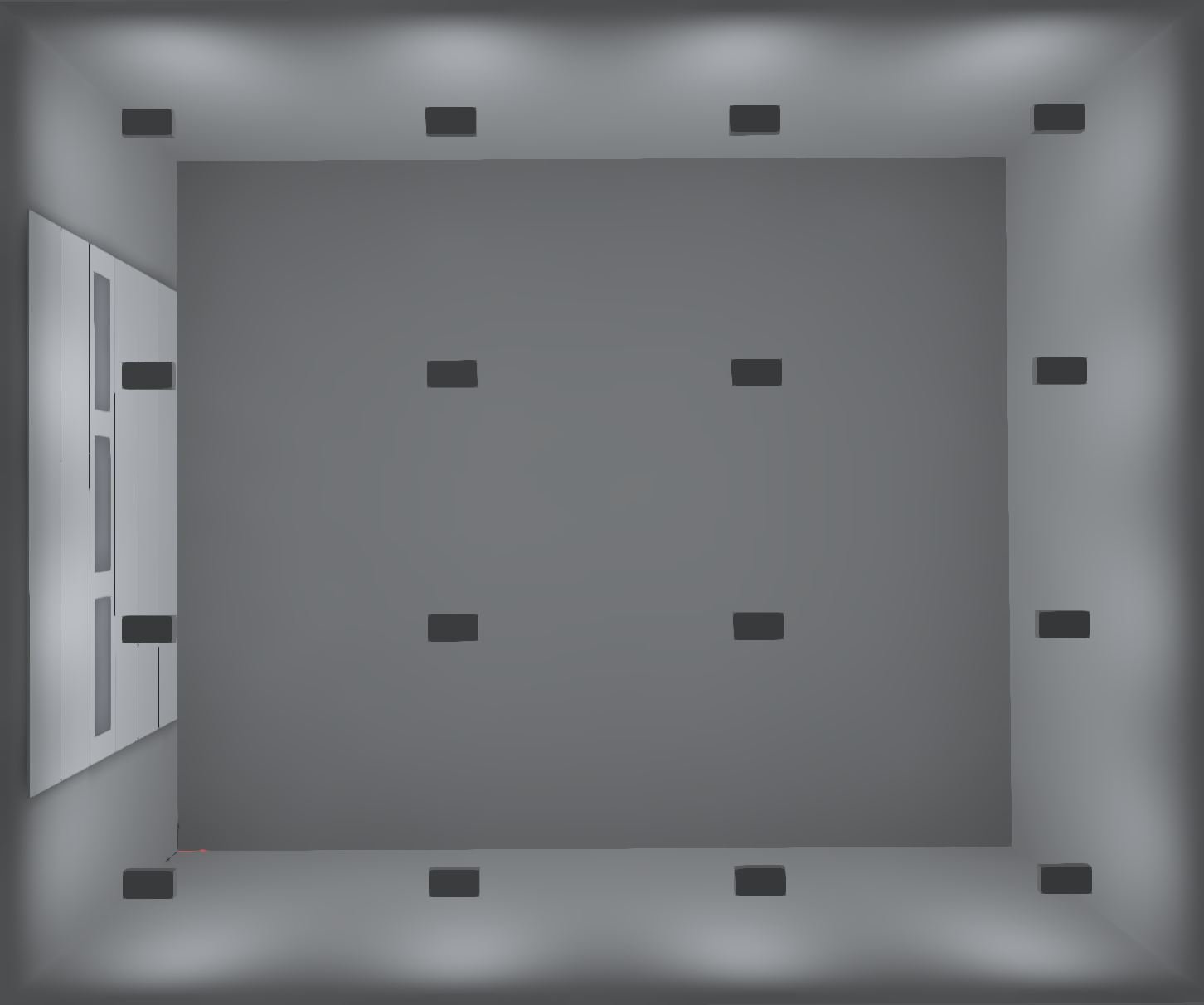

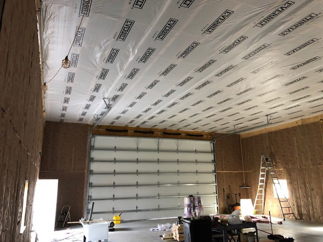

Long time lurker... first time asking questions... I am investigating my options for lighting a pole barn similar in size to what KRAM02 is building. I have read through the various lighting threads and most recently the two threads focusing on the High Bay fixtures for use with 16' ceilings. I have to admit I am a little overwhelmed/confused with all of the different ideas and options.
My interior space will be 39' x 39' x 16' high walls with an open ceiling. There will be sheet rock painted white on the 16' high walls. The ceiling will be open trusses with a white FSK vinyl covering the insulation under the 4/12 pitch roof. I have one 12' x 14' overhead door centered on the front (West) wall. The building will be used primarily for storage of motorcycles and tinkering on my other weekend projects...
I have worked up a lighting simulation using the Visual Interior Tool and the GreenTek/James 110W LED fixtures with a 4 x 4 arrangement. It is showing 119fc with the lights suspended at 15' off of the floor which seems pretty high. Does anyone have any feedback on using the 110W LED fixtures in this arrangement in a building this size? Is this the sixteen fixtures going to be overkill in the area I have? When I change the arrangement to 3 x 4 it drops the Illuminance to 89fc.
I am planning to suspend the fixtures on the included V hooks and chains. Can these fixtures be used with a pigtail added? Or would I be better to consider direct wiring?
Thanks in advance!:beer:
119fc is overkill for the use you described. A concrete parking garage will be around 5fc. Typical working warehouse illumination levels are in the 10-30fc range. For reference, a high school classroom is normally targeted around 30fc. Typical office space is about the same. A working machine shop or automotive shop, anywhere where folks are doing work with their hands, should be targeted for 100-ish fc. You need to over light a little bit because when you start adding in cabinets, machines, etc, you lose a little reflectance.
