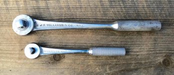

16,590
Here is a pair of Superratchets that I’ve been hanging onto.
