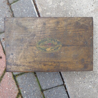

I see there's one of these sets for sale on eBay UK, auction ends Saturday.
August 8th 1924, and it has no sliding T handle.
I've no connection with the seller but got a few pics for interest
